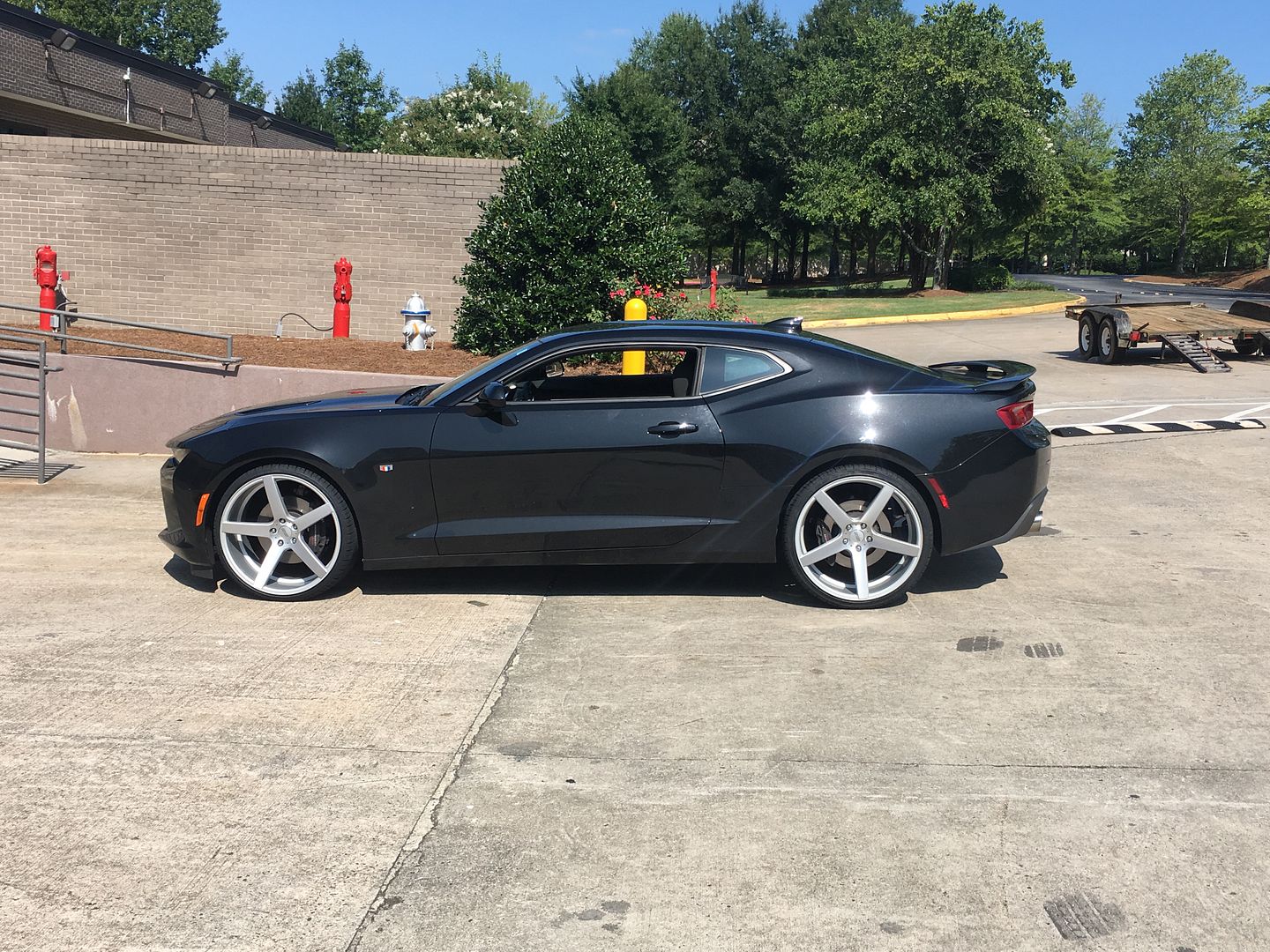

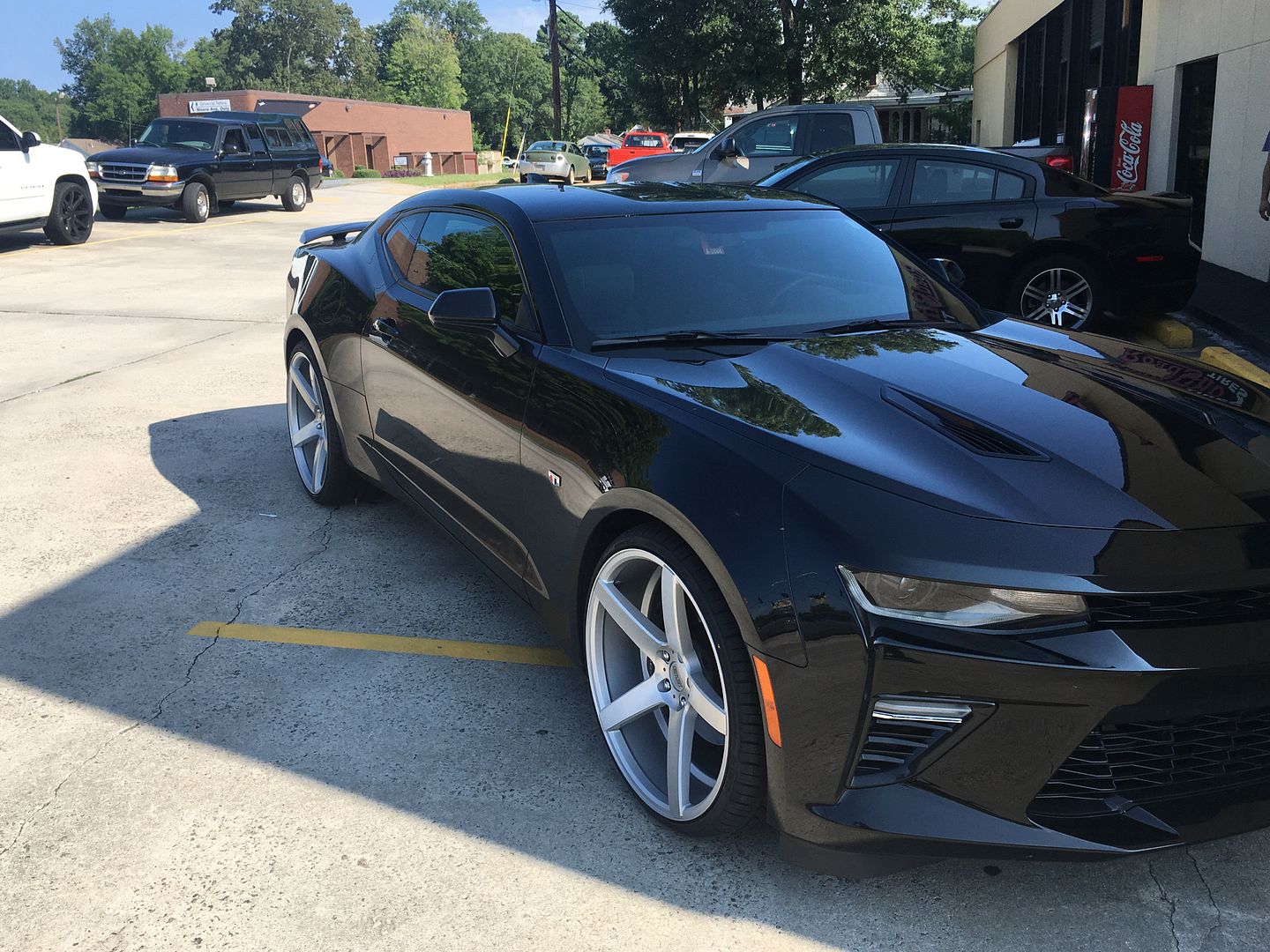

But for the OP - my wheels are squared or all the same size. 22 X 10.5 all the way around. But my tires are 285/25/22 upfront and 305/25/22 in the rears. Like I said earlier if the offset is right you can pull off some 22's on the 6th Gen.

The tire width needed properly run 10.5" rims is a 295.
295 anything I feel is too wide up front. It will ride close to the fender and cause incessant rock chips.
A 6th gen ZL1 can run a 295 up front and be fine though as the fenders come out further.
I'm sure a 305 (maybe a 315) can fit the rears with the correct offset.
I run 22x9/22x10.5 on 255/30/22 and 295/25/22 tires respectively.
