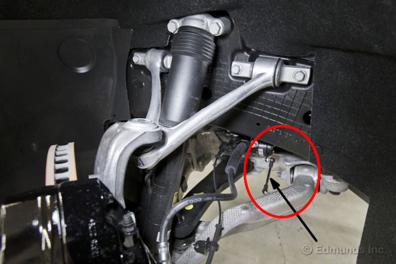

This isn't quite right. The first half of your explanation is correct...MR uses an amalgamation of inputs from yaw, acceleration, braking, steering sensors to determine a setting for the damper. However, one of the most important sensors is in fact, the the suspension travel sensors. I have not clarified whether they measure a static height, or a relative suspension travel distance...but they are there:

+1 surface differences..bushing resistance...alignment...my 1LE was all out of whack when we measured a baseline before installing Z/28 stuff...it was embarrassing.
For what it's worth (I don't know the Gen 6 specs)...the 5th-gen unilaterally had thicker (stiffer) stabilizer bars in the rear for each model.
Personally, I have just two concerns when modifying the suspension on an MR vehicle....1) Does the shock piston have enough travel left to deal with a full compression situation using a lowering spring...and 2) Does the ride height sensor have enough travel left to deal with a full compression situation.
IF....if the ride height sensor uses a static measurement...then I would have a third concern: will a lower setting due to new springs, cause the suspension to function in a non-optimal part of the calibration?
Attachment 837547
I believe the sensor works off of the movement of the suspension , therefore travel of the arm would be a concern if you lower to much. I would think the sensor travel ideally with weight would be in the center of the sensor arm travel. This way you have the same amount of travel up and down. I am sure there is some over travel built into the arm travel. Say 10% in both directions maybe.

Nice pic Mr Wyndham! I still may be right though. Only a MR engineer can tell us for sure, but I would guess that sensor is more to measure the amount and abrubtness of movement. It could also be used for ride height, because I have those on my Escalade and they are used to help the air ride suspension to level the vehicle the best it can, based on load carrying and driving maneuvers. The only reason I don't think the MR really cares about ride height is because all it can do is change the viscosity of the oil in the shock and I'm pretty sure the ride height isn't going to change that, but I could be wrong. They could've very easily programmed the system to stiffen the shocks the more they are compressed to soften bottoming out the suspension. I still don't see that hurting anything other than maybe the ride comfort not being quite as good. The suspension would still have the same bump stops or whatever it uses to limit the compression .....and extension.

I'm with Mr. Wyndham regarding the suspension travel/height sensors... I was in an accident last spring and had to replace some front suspension components, including sensors, and MRC/Steering were completely out of whack (car was too soft and the steering felt like a 90's Deville. TC might have been impacted as well, but I didn't test) when everything was first put back together. The company that owns the body shop also owns one of the bigger Chevy dealers in the area and they had to recalibrate those sensors for everything to work properly again - this is just what I was told - they called GM engineers to find out what to do and had to load a custom calibration program for the Gen6 into their computer. After the sensors were recalibrated (unfortunately I didn't talk to the guys at the dealership and I'm not sure what that entails) the car started driving like it should.
When installing my lowering springs I measured where the sensor arms sit, so I can do the same with new springs and make shorter connecting rods to keep the sensors in the same position as stock. I never got around to doing that second part so I don't know if it actually makes a difference or if a 1" drop affects anything to begin with. My recalibration experience doesn't make sense if those sensors are just for measuring rate of suspension compression/rebound
