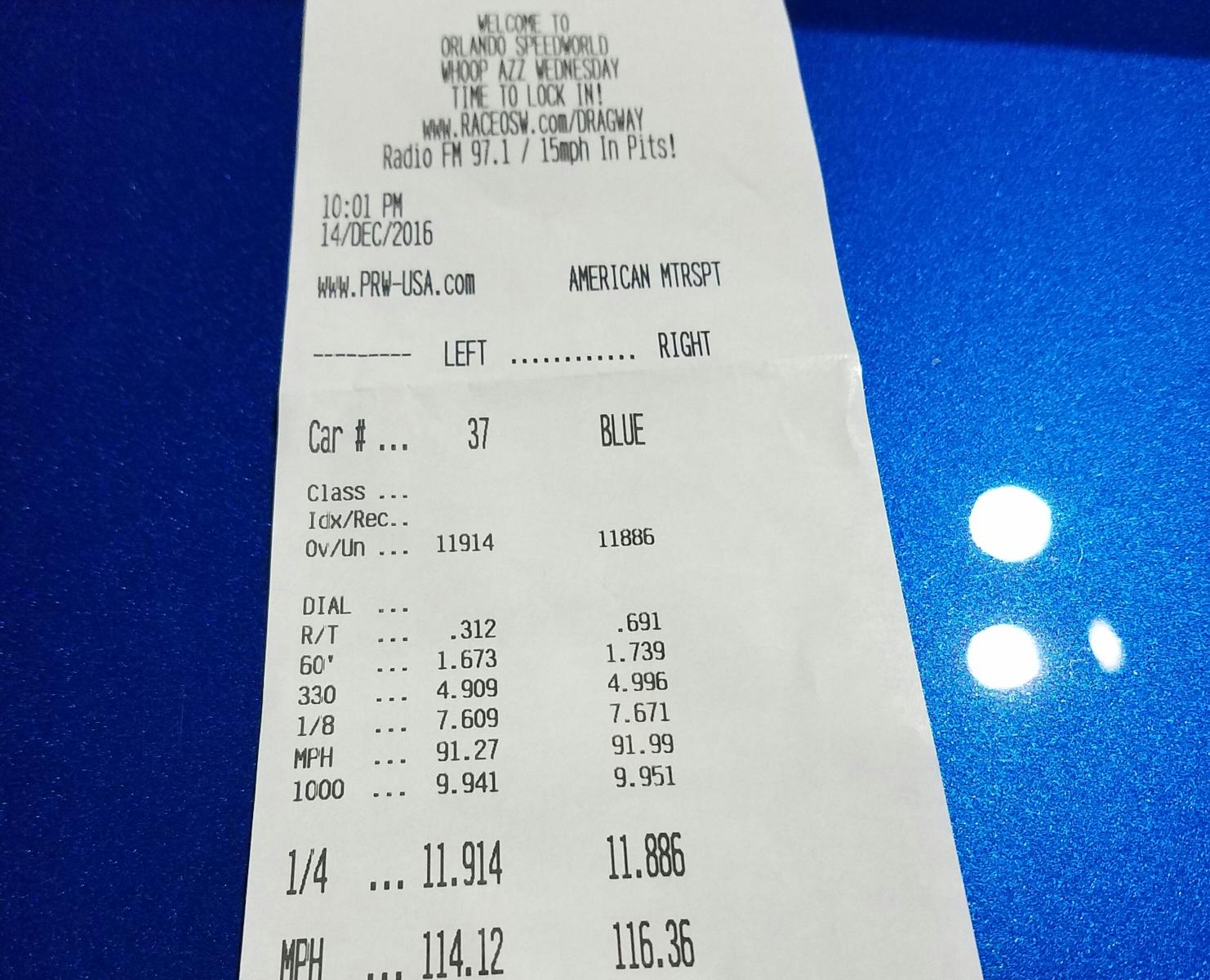

Update: So I went to the track tonight and finally got into the 11s with the best launch I've done so far. 1.8 60ft. Did two other passes but haven't been able to duplicate it yet...life with a manual lol

So I spoke too soon lol...did one more run before I left. New new personal best of 11.8 with a 1.739 60ft. I tried a few different ways but I got my best launch just doing it like I would do on the street...just a little bit more aggressive.
