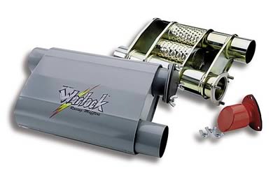

I'm trying to incorporate and justify buying these. By the time I get everything to make the conversion, I will be at 650-700 bucks. Hell I would be too close to just getting an axle back..

that system looks interesting

The Warlock muffler sounds really good. If you welded the factory valve to the straight through circuit, you would still utilize the NPP function. It would be a "mellow " mode as opposed to stealth mode. (6) 45 degree angle stainless steel pipe pieces are needed with these mufflers and they aren't cheap . The only problem I see is the muffler is 3" in/out. Those valves are no larger than 2 3/4".....
