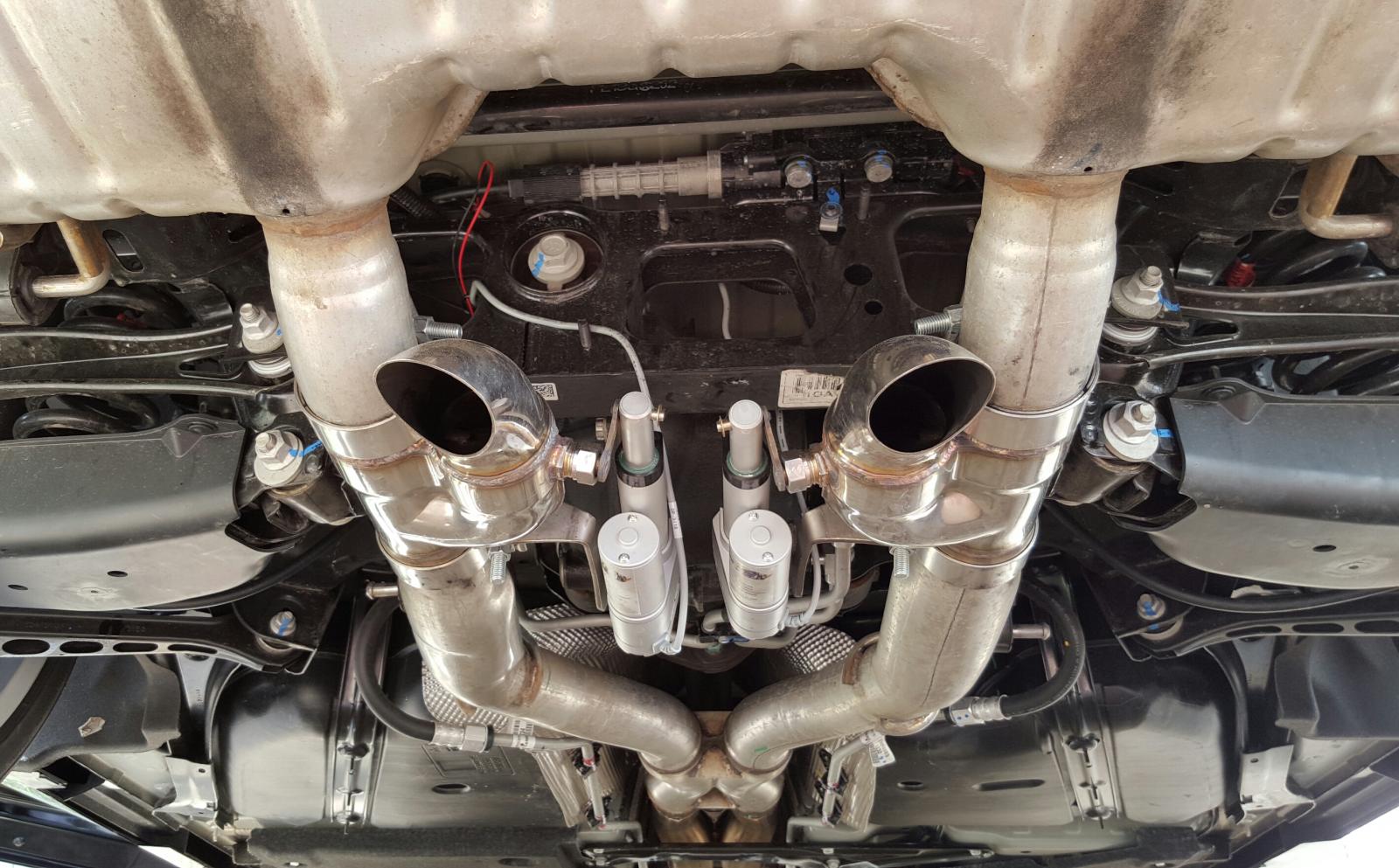

So is there enough space to put cutouts after the second cats? I think that's what the QTP image shows.
Burly is offline   Reply With Quote
Old 11-28-2016, 10:50 AM   #65
SuperSound
SuperSound's Avatar
Drives: '17 Camaro 2SS A8
Join Date: Jan 2015
Location: Eastern NC
Posts: 5,063
Yea the aggressor kit goes on just before the muffler and after the 2nd cats. But there should be no problem cutting out the 2nd cats and installing them there either. There are plenty of people who have deleted the 2nd cats altogether with no issues. Some have thrown codes but these were traced back to leaks when the straight pipes were put in.
