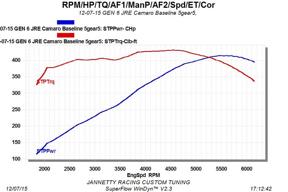

Wait, you'r only shifting at 5000???? You mean 6000?
Nope.... Most every dynos you see the power really falls off around 5500RPM, you may think your still pulling but your not! Shift at 5000,adjust for amount of time to make shift and your around 5500RPM when you change gears. I attached a dyno sheet for you to see. The sheet I attached is one of many online and shifting at 6000 your not pulling anymore.

Valid point, I don't know why I though the power drop off was higher, like 5800...bottom line it's working for you.

but when shifting at 5400 rpm where does it fall back to in relation to shifting at 6400? I was always taught to shift slightly past the peak so rpms drop back down into the heart of the powerband when it hits the next gear.
give it a try shifting close to redline on the same day and report back if you don't mind and have a chance. this is interesting because your results are very good...
I have noticed vids of the auto seem to have the shift completed by around 6000 rpm...and i thought it looked early...hmmm
