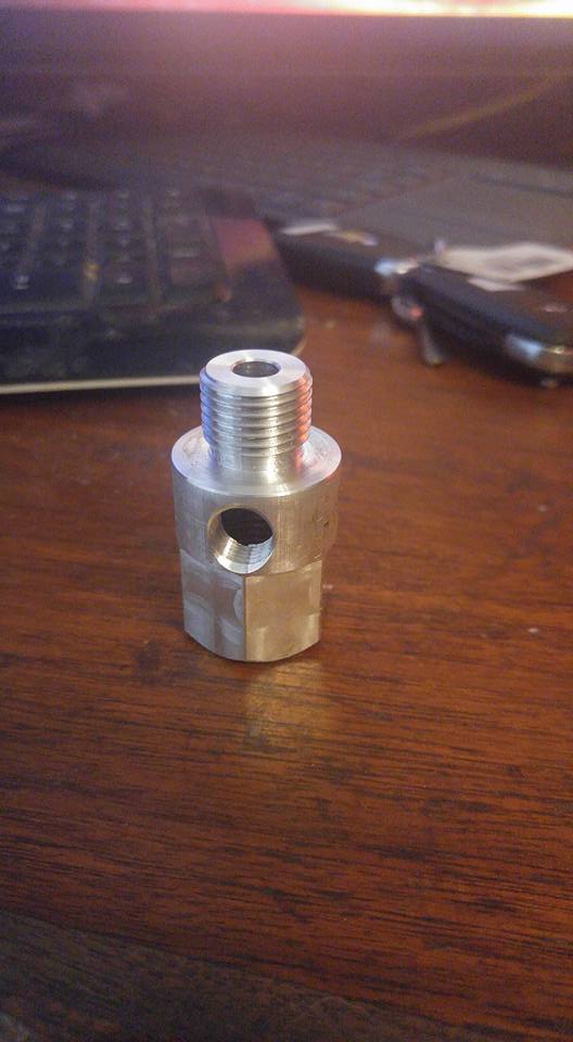

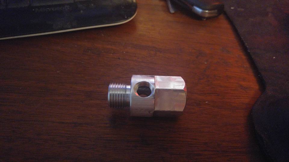

we machined out a pressure t that goes where the oil pressure sending unit is right by the throttlebody on the engine.
Or you can get a oil filter sandwhich plate off of summit. On oil pressure sensitive engines like honda s2000 f20c this can sometimes have a slight dip in oil pressure causing you to lose vtec. I don't think it would be a problem with the lt1 though.
