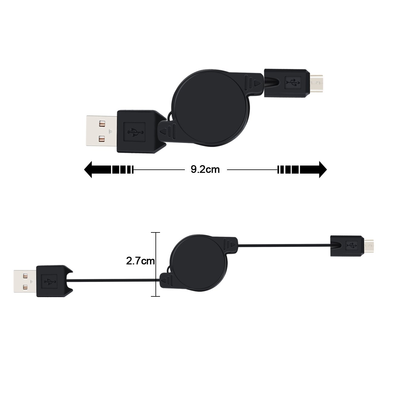

You guys might find this helpful. I have tried several USB cords to attach my phone to the USB port inside the console compartment. One was too long, and was a pain to deal with. The other was too short, so I couldn't get the phone all the way out of the compartment (I like to leave it on top of the console).
Anyway, I found these cheap USB cords that have a little spring loaded reel, so you can make them short or long: https://www.amazon.com/gp/product/B017149DIM
They are not the most robust feeling, so maybe wil crap out after a while, but I just used one today for the fisrt time, and it worked fine.
