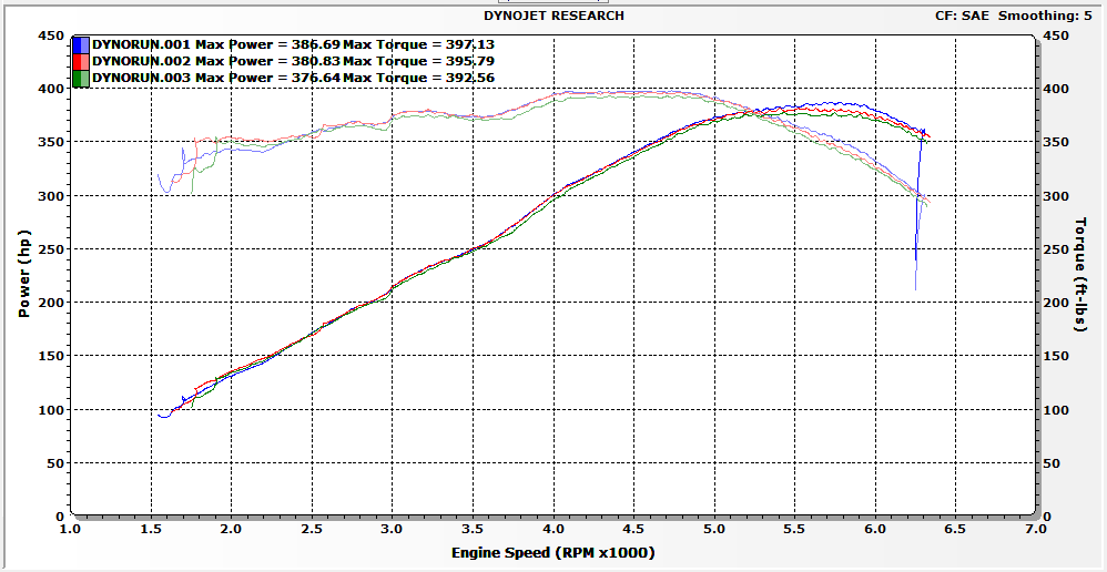

all runs in 6th gear(a8) on a dynojet, damn that is a long pull but it should help once it is boosted.
run 1 open, run 2 closed, run 3 open.
only about 5 minutes between runs, you can see it lost power each run and the closed cut out didn't seem to have much of an effect.

Yeah not sure NPP really gained any additional hp/torqe.. I wondered what competitive mode yields vs track/sport.
On an unrelated topic, If the peak of HP if before 6k rpm and peak torqe is at 5200 rpm wouldn't it make sense to shift at 5200-5500 rpms? Why waste time hitting redline if after 6k the power especially torque will drop?
Just one of the things I wondered.

what is this competitive mode? i see the stealth, sport, track, snow. does an a8 have this?
to figure out best shift points you have to look at the delivered tq to the rear wheels. to do this you have to look at the multiplication of the transmission in each gear. you have to shift well past peek tq in 1st because once you shift to 2nd you loose some gear multiplication going into the next higher gear.
an easier way to do it is with a GTECH and see what your g's are through the shifts. there shouldn't be a big jump or loss of gforce between shifts(not counting during the actual shift).

Ahh got ya.. yeah might be more complicated so I'll just shift at 6k if I want to rip it..
Yes you have competition mode as well. Start the car and once you are in sport/track mode hit the traction control button twice and you should be in competitive mode.
