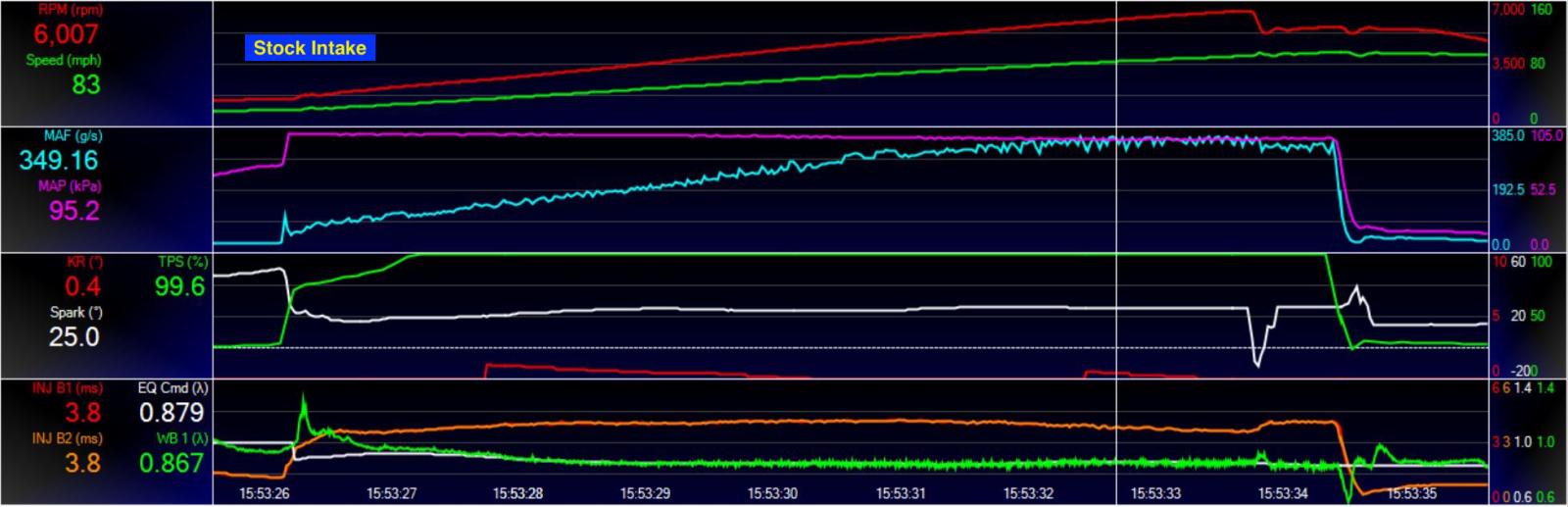

Hermine finally hit my area so the next 24 hours are going to be wet. Once the weather clears this weekend I will be installing my AEM WB and collecting all of the pertinent data on the stock intake. Right now my MAF transfer function is calibrated. In other words my curve is 100% correct for my car versus the factory curve that may have had 1 or 2% error in places. I'm going to utilize the calibrated curve as my baseline. After I have that data I will install the Rotofab unit and measure the same set of data. I will show the AFR error introduced (if any) and then show what the calibrated curve will look like for the Rotofab intake vs the calibrated curve for the stock intake.
This approach will eliminate all other variables and get right down to determining what the intake is going to do to your AFR across the range compared to the stock intake. I will do this in the afternoon so there is minimal weather variance to account for.

Quick update... I will post specifics later tonite.
So I would like to say great job to Rotofab. I am very impressed with not only the construction quality of their intake I am impressed at how accurate they kept the MAF output. The variation on AFR was sub 1% across the RPM band. This was data collected in MAF only mode in the ECM which really isolates the AFR from being influenced by other variables. I did 3rd gear runs (A8) from 1500 RPMs up to redline. The stock vs RF runs were within a couple hours of each other with minimal weather variation.

Here is a snapshot of the runs for each. You will see the commanded EQ (white) and the WB (green) lines. If the MAF output is not skewed they should sit on top of one another. The Rotofab intake did NOT upset the MAF calibration in any meaningful way. I am very impressed and to be honest did not expect this.
Rotofab did an EXCELLENT job keeping the MAF from getting screwed up.
