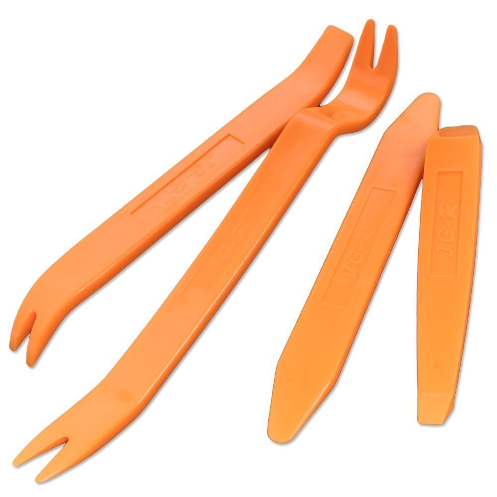

Originally Posted by Zack46 View Post
I got a set of these as well. Do they help taking the fasteners out??
Yes, the 2 pronged one with the bend gets right under it and allows you to pry up while rocking sito side

Originally Posted by BloodiedWraith View Post
Got mine installed, but I had a question for everyone. What the hell is the trick for getting the trunk lining fasteners out? I swear that was the most difficult part of the entire installation.
Replace them with push-locking-tabs of similar size from Lowe's... those idiotic fasteners are a pain to get out even with a proper tool

$6 on Amazon Prime.
https://amzn.com/B00HNMLQAG

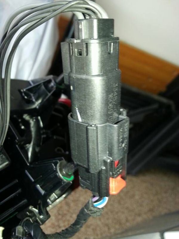

Originally Posted by vet757 View Post
That wasn't the issue. This was the issue:
For the life of me I couldn't get the connector apart even after sliding the retainer back to release it.
Camaro/Firebird fan since 1977!
Previous rides: 1965 Pontiac GTO, 1977 Trans Am Special Ed. "Bandit", 1996 Camaro 3.8, 2002 Camaro Z28, 2014 Camaro 2SS/RS M6 Spring Special Edition
Current ride: "SOUTHERNCROSS" - 2017 Camaro 1SS Silver Ice Metallic/Jet Black w/BO4 56V RZ9 NPP SFE SH1 VW9 W2D
"And no BS! It's (the 1SS) everything you need and nothing you don't." -Craig Cole on the 1SS vs 2SS
"Reach above your dreams of pleasure, giving life to those who died. Look beyond your own horizons, sail the ship of signs." -RJD 'The Sign of the Southern Cross'
Blue's SS is offline   Reply With Quote
Old 08-20-2016, 10:26 PM   #504
BloodiedWraith
BloodiedWraith's Avatar
Drives: 2016 2SS
Join Date: Oct 2012
Location: New York
Posts: 282
Slide the red switch down and then squeeze the black tab that is "unlocked" from moving the red switch down and it should pull apart. Left light was far easier for me than the right one lol hell taking the right light out was even harder than the left for some reason.
