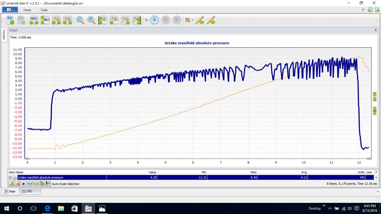

This plot is the manifold pressure in psi. What I'm questioning is the fluctuations. Is this normal for a PD/Roots/TVS Eaton?

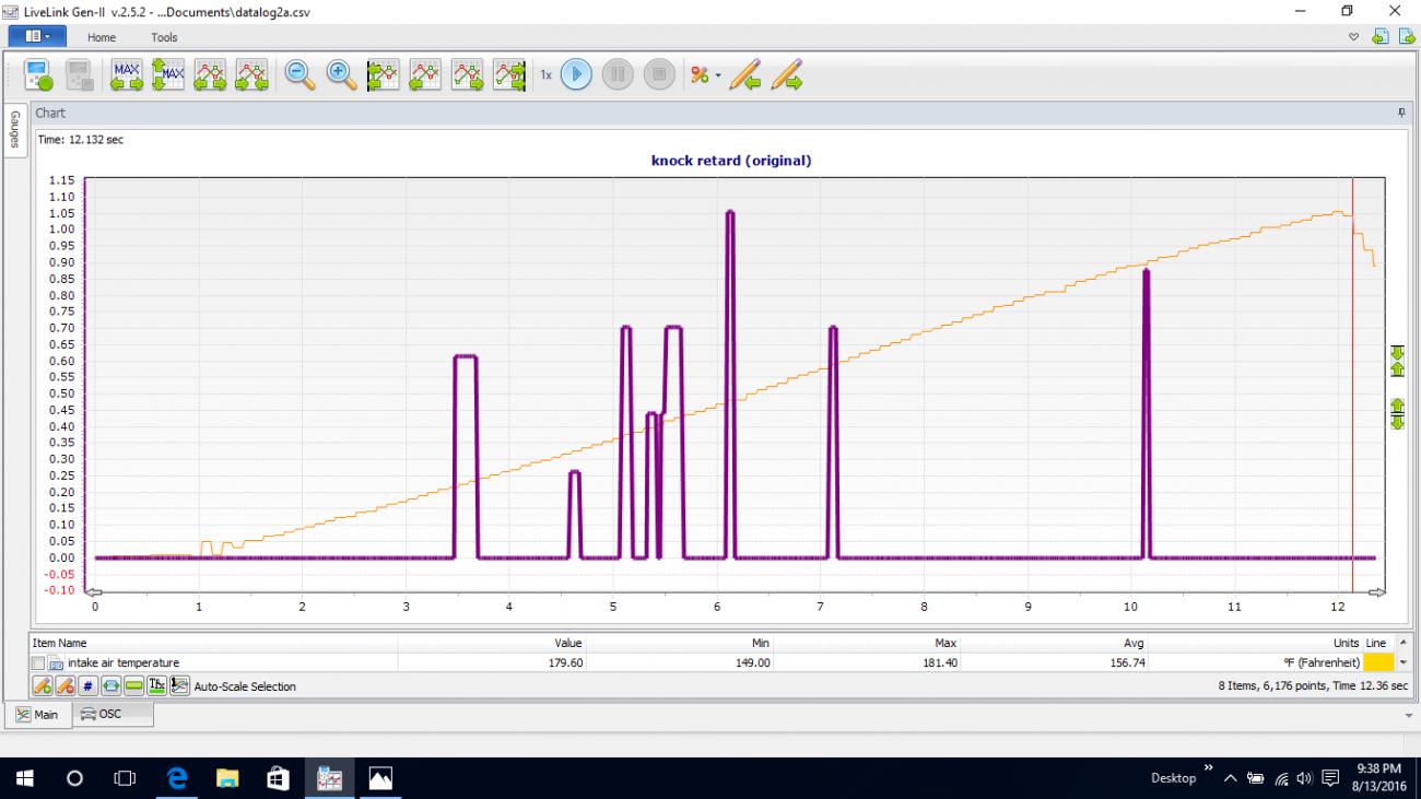

Here's knock retard in degrees. One degree knock retard occasionally seems not too bad, but will work on it with temp reduction.

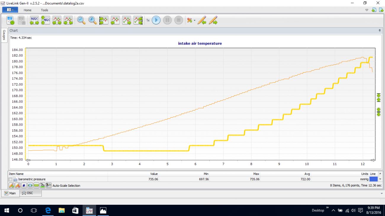

And here is intake air temp in degrees F. This will be an area I'll tackle later to reduce if I can. Is this too high?

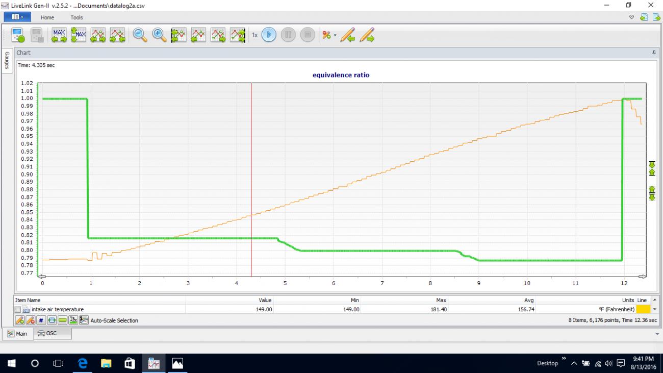

Next is lambda. Looks OK too me.

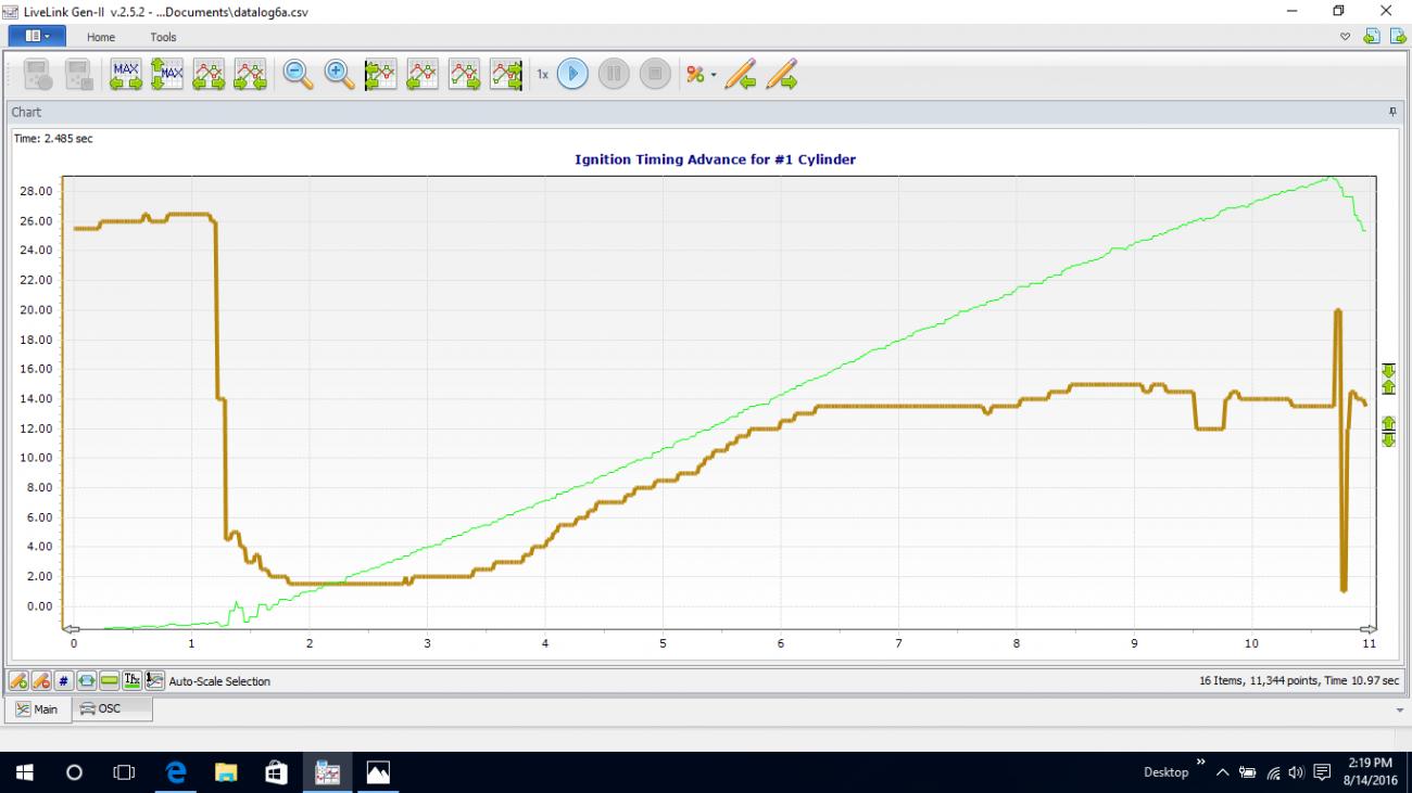

Timing advance in degrees. I noticed the timing pull due to knock retard at around 5K rpm. Could use some comments on this graph.

Your MAP sensor readings are normal, all of Edelbrocks systems do that, it's due to their placement of the MAP sensor...
The timing dip is most likely due to the knock event at the end of the run.

The MAP sensor readings look like belt slip to my eyes. I would expect some very slight fluctuations, but not the saw graph we see here. If you check around your blower pulley is there any fine black powder? Do you get any on your fingers if you check? That could be a sign of belt slip as well. I wouldn't expect any at 7psi.
In 90° air 1° of STKR isn't bad. I assume your running 93 octane fuel? Ideally you'd like to see this no more than .5° but again, not a major concern. Your topping out around 14-15° of timing which ain't bad on a stock motor at 11:1 compression. Should feel pretty good.
I'm surprised by the IAT. 182° seems a bit high to me, but your starting point also seems higher than I would expect at 148ish. Was this after romping around in the car or was this cruising to your designated test track easy then romping it? This could be one area for improvement.
The Lambda graph looks spot on after I did the conversion. I'd recommend switching that metric to "AFR" if possible to give readings most people are more used to seeing, like 11.8:1 instead of .80 for example.

It shouldn't be belt slip. I've done a lot of E-Force calibrations over the years, they all do that...

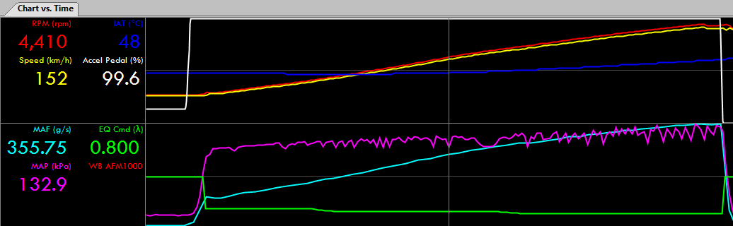

Here's a 16 SS from the other day with an E-Force.

Harder to see the scale on your above screen shot. On the OPs it's fluctuating by 3psi on the scale. Is yours the same?
If so, what causes it?

Thanks for your reviews Speedy and yonson. I'm glad to see someone else come to basically the same conclusions that I have; MAP fluctuations and heat.
The belt is doing fine, no slippage.
I sent the top screen shot of the MAP sensor to Edelbrock and they have already responded! They also think that the MAP readings are fluctuating too much. I just finished an actuator test with a hand vacuum pump and sent them the results. We'll see what they say.
