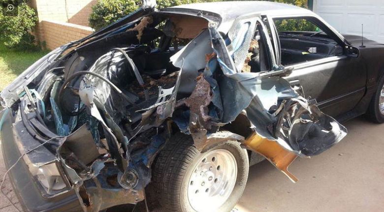

http://jalopnik.com/what-a-car-looks...s-in-706539520
