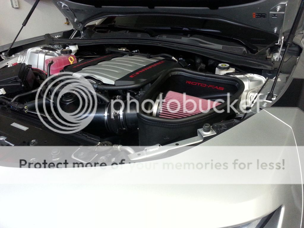

I am confident that some of our dealers will offer the Roto-fab intake package with a specific tune for our system.
Roto-fab intake, pre-production

I'm sure the Roto-fab intake works well. The thing is, at least for me I don't want to mess with my warranty

The ECU/MAF will more than likely compensate for the air intake alone and not throw a CEL. However, a good tune will increase performance even more. The powertrain warranty is the dilemma for most for sure. Even if you have a problem that is not related to the CAI you run the chance of being jerked around.
