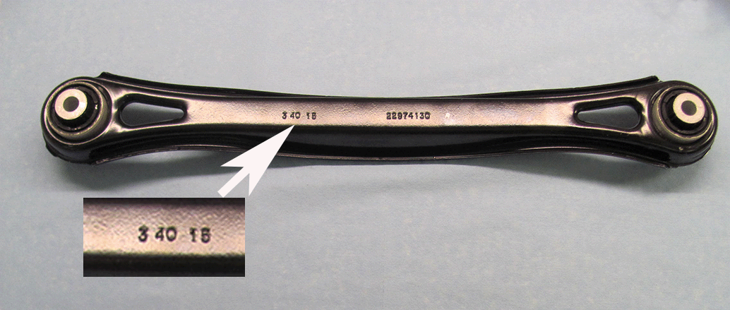

well, mine was included. The car was built 12/18/15 and had the bad date codes on the brackets. I was able to confirm the numbers with the camera on the phone. I brought it in to the dealer today for inspection. No cracks found and no further action needed. So, back to enjoying driving it!

My car is being inspeced for it now after my first oil change. I had to tell the dealer about it they didn't know but they found the service bulletin. My car was built in Dec so hopefully they have the parts if it's cracked.

No...The stamped numbers are to the wheel side of that sticker. That confused me at first too...
They could be on the otherside of the toe link as well. Not necessary to be on the wheel side. Check both sides...

008 16 on the passenger side

Checked mine this morning, on the passenger side 285 15 was my number.

Checked mine and it is 303 Oh well, I dodged the oil pan bullet so I won't complain.
FWIW - I have a track day coming up and may not be able to get to the dealer before hand so I wanted to inspect these myself. I had the car in the air with the wheels off (bleeding brakes) and there was no signs of cracks in the areas indicated at the beginning of this thread. My car only has 2100 miles on it and has not been driven in the rain so they were very clean and it was easy to see all areas with a small mirror. So maybe...just maybe...even if you have the 303 or 340 numbers you may not have cracks. Or it may just take some time for them to get large enough to see
I still plan on having the dealer take a look as soon as I can, just to be safe.

Checked mine today while at the dealer getting my free oil change! 285 15. Looks like I missed all the recalls so far! Oil pan good as well!! Thank god!
