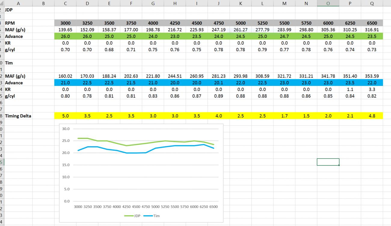

Here is the data from the JDP log vs my log. As expected there is a significant timing advance delta between their car at ~4300 ft and a car that is close to sea level.

I had a two hour flight to look at things a bit closer. There is some advantage coming from the timing table itself but the bulk of the timing delta is coming from the IAT adder table. The JDP was around 50 degrees IAT which would be ~2.8 degrees added across the board. Timing work is definitely needed to get the midrange maximized.
