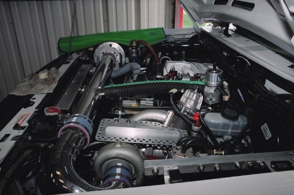

You "Old School" guys might remember back-in-tha-day when Dr Jacobs (infamous for developing the heart pacemaker) had a car hobby and was tired of his MSD boxes failing... so he created his own. Then he added a controllable Boost Retard and everyone I knew with a Turbo or Vortech bought his products as they never failed... kinda like the heartbeat of your engine depended upon it! Dr Jacobs also created a truly badass Porcelain Ceramic plug wire which was revolutionary when trying to stick a wire through a "basket of snakes" turbo manifold on a 331ci Ford with twin turbos or anything Corkey Bell fabricated.
Then the Doc got bored and sold off the company to an investment firm not known at the time to own MSD. They shut down the competition... and the story ended for a few decades. Or so I thought, until I contacted him.

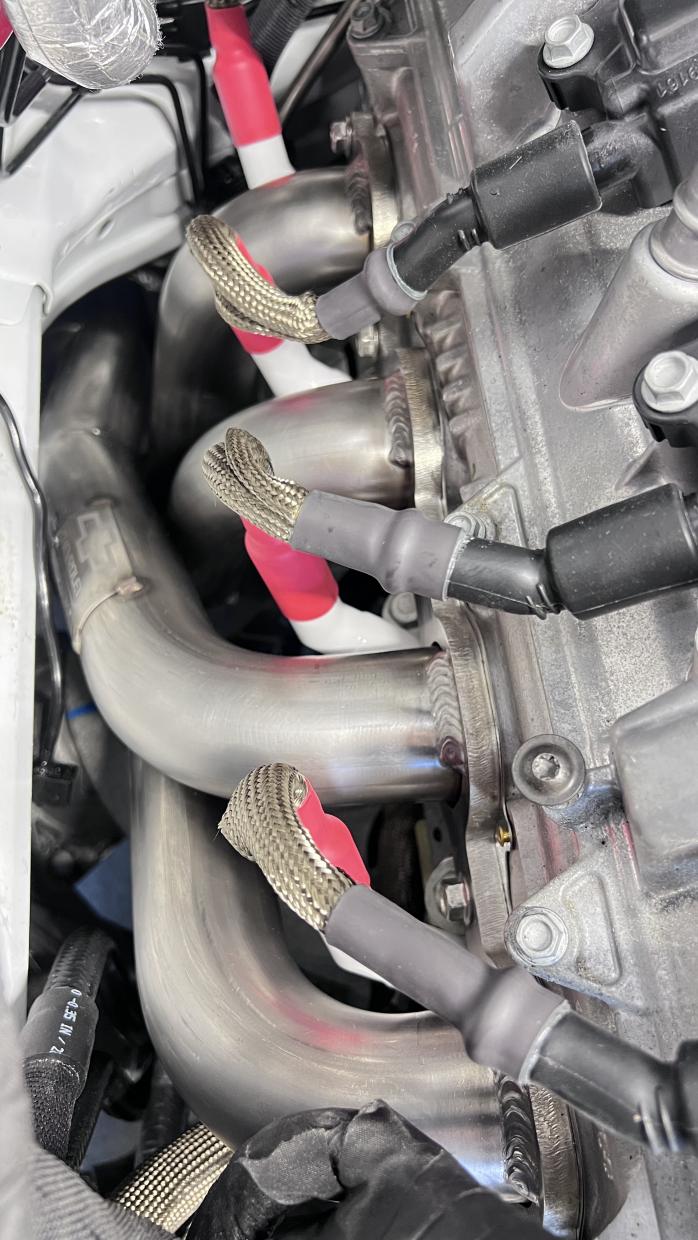

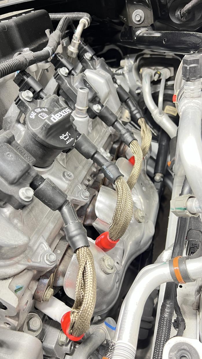

When I needed new plug wires, I bought a set from Katech... and they were and have been stellar with the proper Ohm resistance, reach and the boots were "okay" with sleeves upon them. I added Marine heat shrink and titanium/kevlar wraps and called it good. Over the past year, they worked perfectly... no issues, but then the door opened up for me to buy the components to make my own, with the exact specs needed for proper coil dwell and zero misfires recorded in the past six months over thousands of miles and not one fouled plug or failure.
I now wrap my own with a double layer of titanium/kevlar wrap, sealed with an epoxy-lined heat shrink that seals the boot, cable and wrap tight enough that it can be yanked on with soft-grip pliers fresh off the track. Both cable ends lock onto the coilpack and plug with a distinctive "click" so you know its set!
We used to build crazy stuff in the 1990s... and by today's standards it is crazy that we made it work.

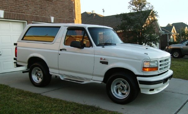

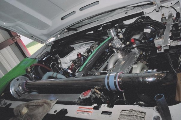

The truck below is my 1995 Bronco with a 1995 Ford Lightning drivetrain, 427ci Kuntz & Kraft Windsor with a T72 turbo and it ran a best time of 10.17@122mph in 1996-ish at Bradenton's Fun Ford Weekend!
