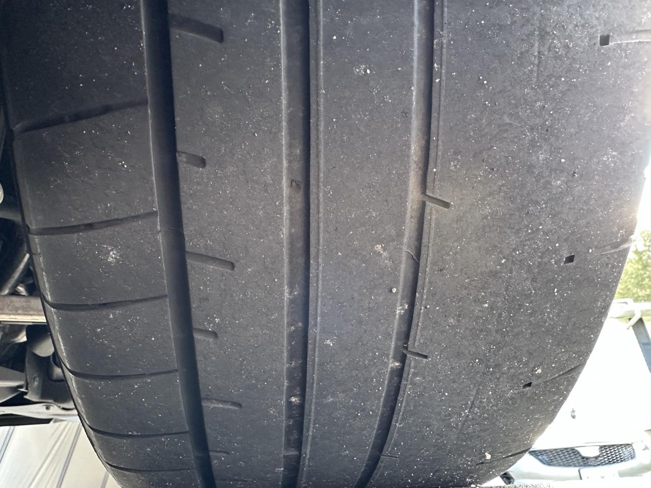

'23 SS 1LE on stock Supercar 3 tires. 13k miles, no track but plenty of very "spirited" driving on the backroad twisties and lots of aggressive cornering especially on my favorite cloverleaf interchanges.
Tons of outside wear on the front tires. Pretty even driver-v-passenger side. See attached picture.
Is this what I should be expecting to see for these tires with normal "street" alignment (assuming that is what comes OEM)? Or is this indicative of something I should look into?
Planning to move to PS4S for significantly better wet performance... looking for feedback if any alignment or other issues I should be thinking about ahead of new tires.
Side note- shockingly, the rear tires still have a legal (above wear bars) tread depth despite my best attempts to "enjoy" the car

What’s a tread gauge say? It still looks like the depth gauges on the outside are pretty deep.

Looks pretty normal. The outside tread grooves are pretty shallow, but there is a lot of rubber there. The depth holes show a lot of rubber left.
Not necessarily great for dealing with wet roads on the street, but no issue for track driving (which is really what the tire is designed for).
The PS4S is a good choice for street driving.

Normal for factory alignment, which is usually about -1.2*. More outer shoulder wear tells us the need for more negative camber. More negative camber will add some more stress to the inner shoulder, just don't go nuts for the street. Some will say track negative camber doesn't add to inner shoulder wear. I disagree. It does play a part, along with toe. There's no free lunch.
I set my front street camber to -1.2*, zero toe.

Thanks for the good info... nothing seemed like a slip in alignment, especially with both sides similar, so good to hear this seems like normal tire wire for tires/car. And definitely more rubber left on outside shoulder, so gonna run it hard for a while longer, skipping the rainy days as I have been doing.
Maybe get rest of this summer on the stock SC3s and then get new PS4S next year. Saves a few bucks and I do love the sticky of the SC3s.

The skinny outside groove is only molded to about half of the usable tread depth on a brand new Supercar 3 tire. There are only wear bars on 2 of the grooves (the 2 inside grooves).
You can check the holes near the outside edge with a tread depth gauge to see how much rubber is remaining before the cords.
