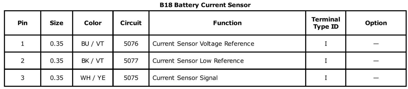

The Camaro uses a Hall-effect Battery Current Sensor on the negative battery cable in the trunk. It’s a 3-wire sensor (5V reference, ground, and PWM signal) that sends a ~128 Hz PWM signal (duty cycle typically 5–95%) to the Body Control Module (BCM). The BCM uses this data along with voltage and temperature to control the alternator via the L-terminal.

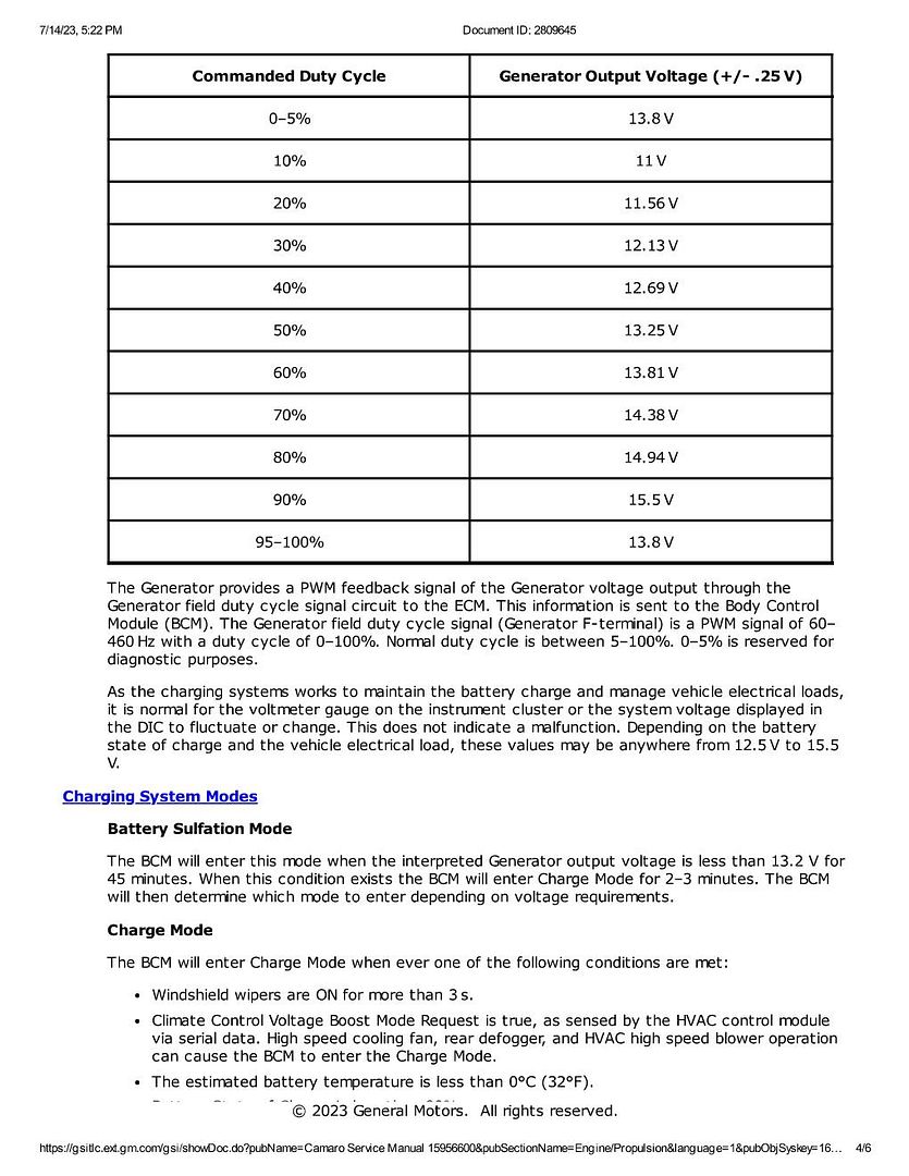

From the service manual, the alternator responds as follows:
• 0–5% or 95–100% → 13.8V (diagnostic/fallback mode)
• ~60–70% range → roughly 13.8–14.0V (my target zone)

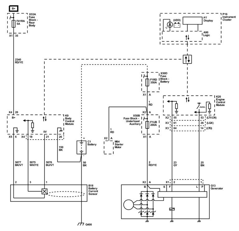

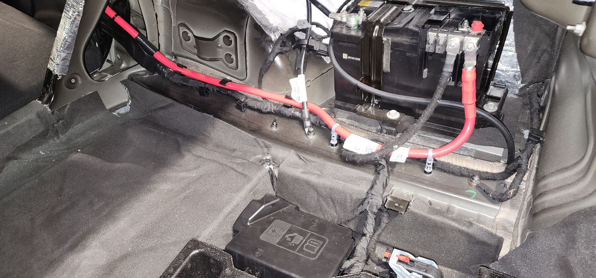

When I temporarily unplugged the sensor, voltage climbed to 14.8V — too high for comfortable long-term use. You can see the current sensor in this photo (on the ground wire):
The sensor is in the schematic as shown here:
The BCM has fallback logic: when it loses the current sensor signal, it switches to voltage-only load shed and idle boost tables.
