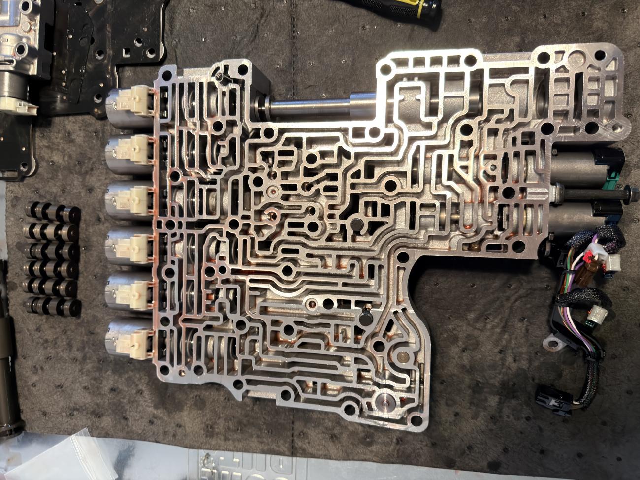

ric': Here are the images I hope are helpful:

Posts: 7
Update: Talked to Tyler at NGD and he thought that I may have a bad wiring harness. I ordered a new harness, actually there is a pigtail at the end that you also have to order. I got everything installed again and filled with fluid. Tried driving it but kept getting a p2732 code. So I'm going to see what Tyler says tomorrow.

This is going to be a silly question, so please forgive me, but - were you diligent in making sure ALL of the shift valves for those solenoids could literally plop out of the bores, under pure gravity, with no outside influence? That is, would they literally fall out of the bores by just tipping the valve body on it's end? Those valve cannot hang-up on anything at all, to my direct experience and understanding.
I'm sorry for your continued frustrations and fighting with this thing.
