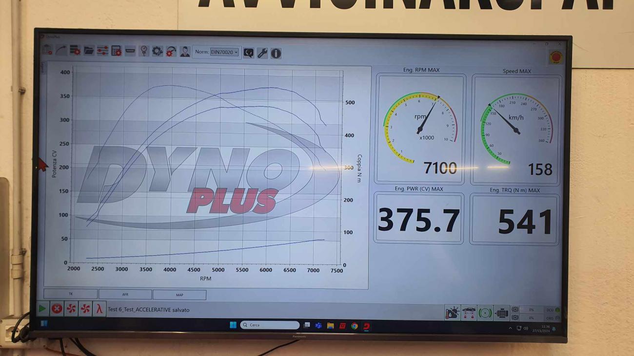

Last dyno test
Last dyno test

Finish!

Very nice numbers, close to square, too For other readers' sake, max torque was 399 lb-ft. Torque falls off fairly quickly past 5k rpm, but I don't think that's unexpected with the LTG.
Here's to hoping your engine will stay healthy with this tune

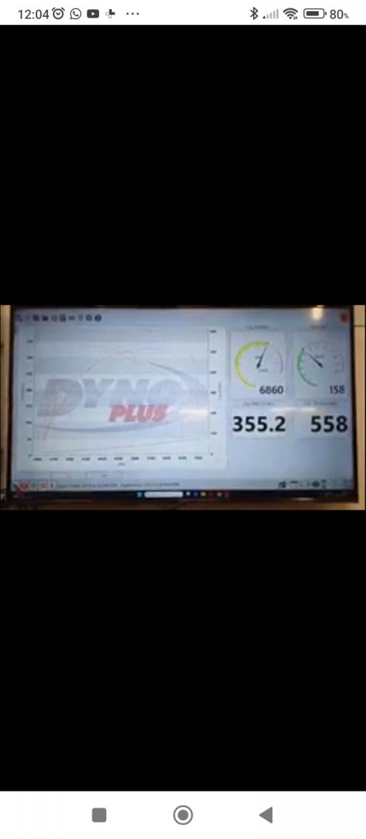

Last test...

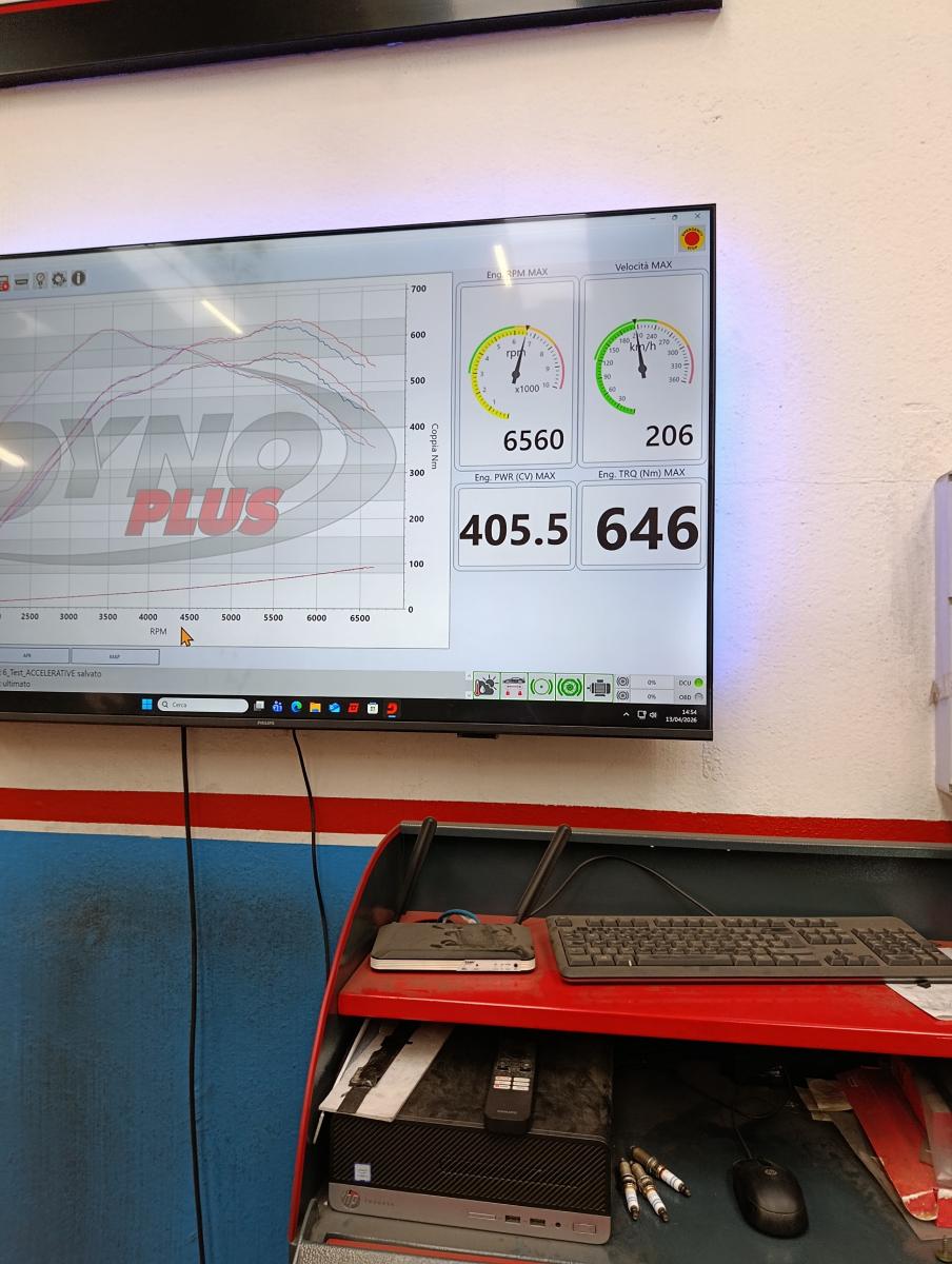

Last update!!!!
