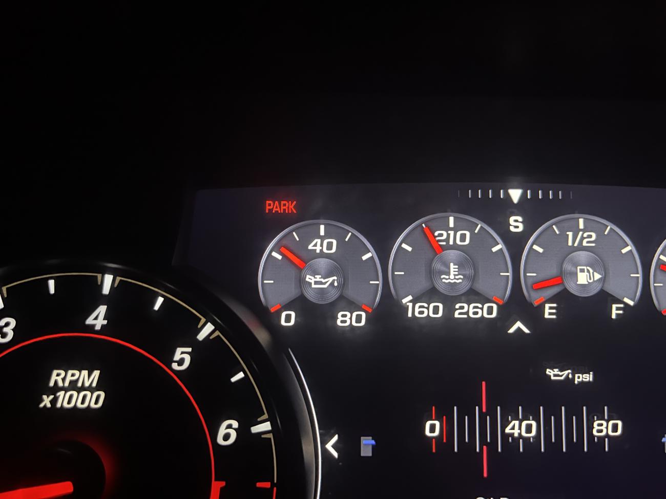

Oil pump ??
Went for a short drive to the store with all gauges reading normal pressures and values..etc. Arrived at home with oil pressure around 23psi at idle. 2019 with 28k miles. Thoughts? Oil pump

Probably. Don't start the engine again. Tow it to service.

Most likely your outer oil pump ring/race has cracked. You are on borrowed time.

Originally Posted by Spacecowboy13 View Post
Attachment 1174117
My 2017 looks the same after driving and the engine warms up. Mine has around 29,000 miles and still no failure. Keeping fingers crossed and watching constantly.
