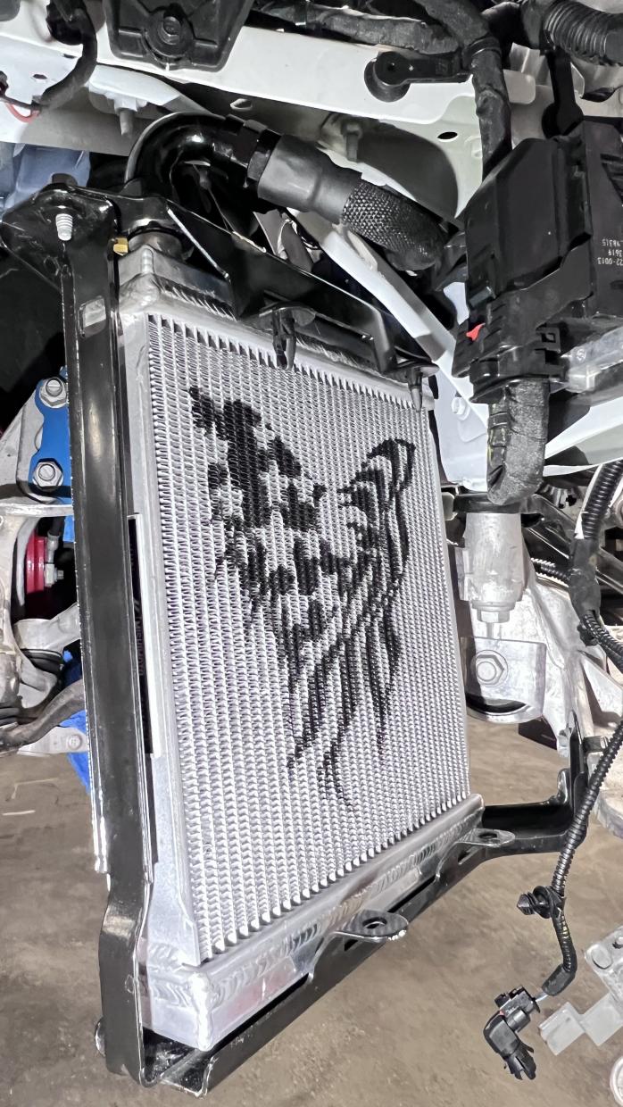

DIY oil & inter cooler setup
Since the oil gets way too hot when tracking the car I looked into oil coolers and searched for recommendations.
I ended up by building my own. The plug and play solution from mishimoto would have been enough, but it would sit in front of the intercooler.
As well I have removed the aluminium front bumper for better cooling and it actually looks awesome.
Used some glass fibre soaked with epoxy to hide the cutted bumper, when it dried, spray painted it black.
Used parts:
All fittings and hoses are PTFE version, for high temp and oil resistance.
1x Mishimoto 25 row oil cooler
1x Mishimoto Sandwichplate (M22 version)
1x Mishimoto M22 bolt to mount it
3 Metres of An10 hose
2x 45° An10 fitting
2x M20x1,5 to An10 (to install on the sandwichplate)
1x 90° An10 fitting
1x 93°C thermostat for the sandwichplate
A small bottle of fluid sealant.
Heat wrap, aluminium wrapped aramid to isolate the oil cooler next to the catalytic converter and to wrap around some intercooler hoses.
For the intercooler the following parts:
1x Big setrab cooler
2 Metres of 25 OD and 18 ID cooling hose
2x Hose connector 19mm
2x 19 mm to M22x1,5 fitting
2x 90° fitting with 19 mm OD to connect hoses
After the first test drive today, the engine oil did not exceed 93°C under similar conditions where it usually reaches 110+°C. Was happy to see nothing leaked.
With this setup, the downside seems to be oil drainback into the oilpan.
Its helpful when changing oil viscosity before going to track tho.
I am still figuring out, if the entire oil cooler empties itself, I might increase the cranking time during the engine start for safety reasons.

Now with a stage1 cam and LS7 lifters and new valvetrain which comes with more power I plan to add a second Mishimoto 25 row cooler.
It would replace the passenger auxiliary cooler which atm just cools regular engine coolant.
Both oil coolers are connected in a parallele system using Y-pieces. All with AN10 hoses.
And as well I might install a 180°F / 82°C water thermostat which I got already here. But a little afraid of too cold heavy oil when cruising on the street.
The second oil cooler would roughly or better said at least decrease the oil temps by another 27°F / 15°C.
My estimated oil temps at track then would be 105-115 in °C or 221°-239°F.

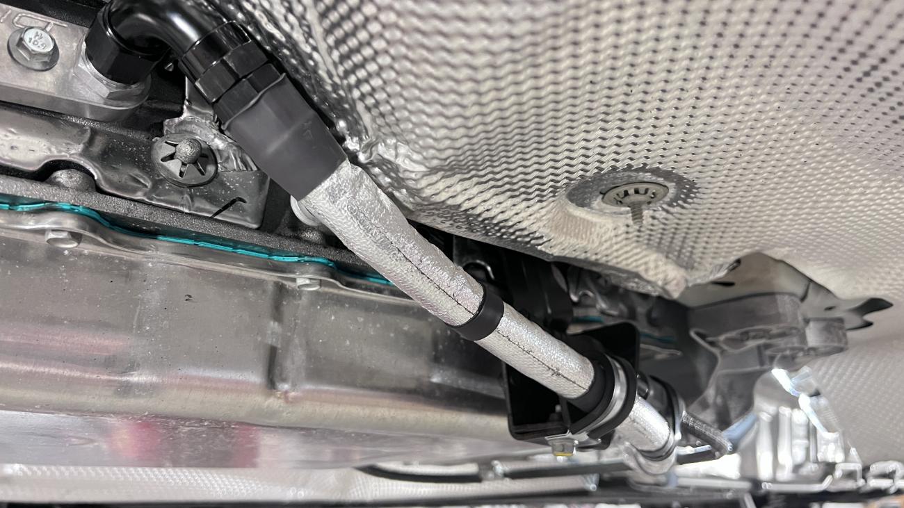

Now installed everything, all went good and there is barely enough room to install the necessary Y-Splitter and additional hoses.
Only way to route everything in front of the steering rack.
Barely clearance to route the hoses between sway bar and tie rod.
Used some fibre glass heatwrap with a soft silicon coating to protect the hoses from rubbing.
I also paid attention to match total hose length of each cooler (inlet and outlet) to be similiar in order to attempt a even 50/50 oil flow in both of them.
Yet it's all leak free, but I only cranked the car for a whole minute to fill all lines and build oil pressure.
Tomorrow I will change oil filter, start the engine for some minutes and do an oil change + oil cooler flush.
I notitced white stones in my oil cooler (caused by coolant in the oil after cam swap, even tho I did an oil change).
After checking again for any leaks I will re-install the fender liner, few underfloor parts but I actually like the big gaps in the aluminium skid plate for cooling purposes and inspecting.
+ Creating a fibre glass air duct to close the gaps between oil cooler and oem air duct for maximized air flow.
It really took longer than expected but definetly a good investment for track use.

Edit: After lots of thoughts, I think there a big air pockets in each of the coolers. At WOT I have few PSI more oil pressure than before. (but still less than without any oil coolers. So it definetly does not bypass the entire oil filter)
After installing the oil coolers I cranked the engine to build oil pressure and to "bleed" the air out.
I disconnected the lower hose at one of the coolers, because I wanted to flush/clean it and not alot of oil came out.
So I gotta remove the upper hose on each and try to prefill with a funnel oder pump.
Will do during next days + finishing the air duct.
I will keep you updated and if all works fine and weather is good, I will be able to post log files with track use in 2 weeks.

At both coolers, inlet is bottom side so its got better chance to push air out.
Connecting two coolers in series would increase resistance I believe, but definetly would lower the cooling.
Pre cooled oil would oil flow in the second oil cooler and the cooling power is reduced by less Delta. (Difference between ambient and oil is less, so its cooling effect.)
I really appreciate your input and to exchange thoughts and sights.
But having in both coolers nearly no oil shows that there is really ~50% less flow and reaching pretty much laminar flow. By this reason it only flows through a few cooler rows.
But once they're pre filled I am sure the cooling benefit is massive.
The benefit of 50% less oil velocity, the oil pressure loss in hoses, full bent high flow fittings is very small.
Yes, this might also decrease cooling power inside the cooler by a little.
I will keep you all updated.
