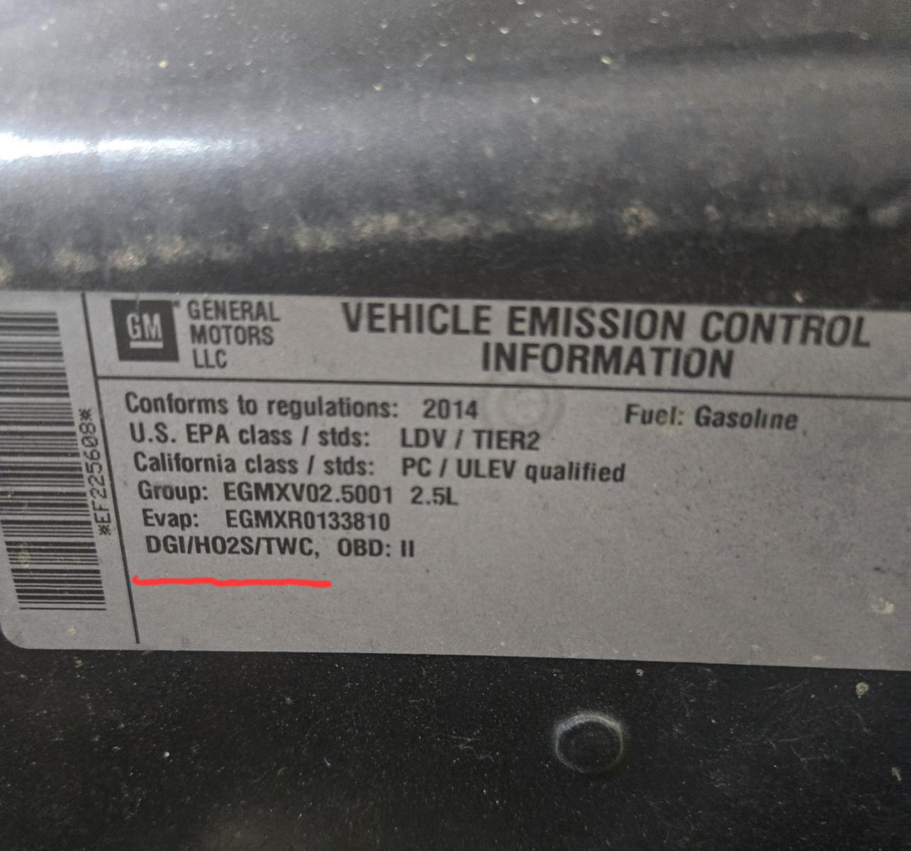

Emissions components are 8year 80k miles for all states. But it's got to be the emissions component, like a catalytic converter, egr valve, secondary air pump. But if any code not related to the component or could potentially be causing the component to fail then they will push for that to be repaired out of pocket first.
Here is an example of emissions components equipped to this malibu im working on.
Direct gas injection, heated oxygen sensors, three way catalytic converter.
Ive personally never seen them cover injectors but it could happen. Cats i have
