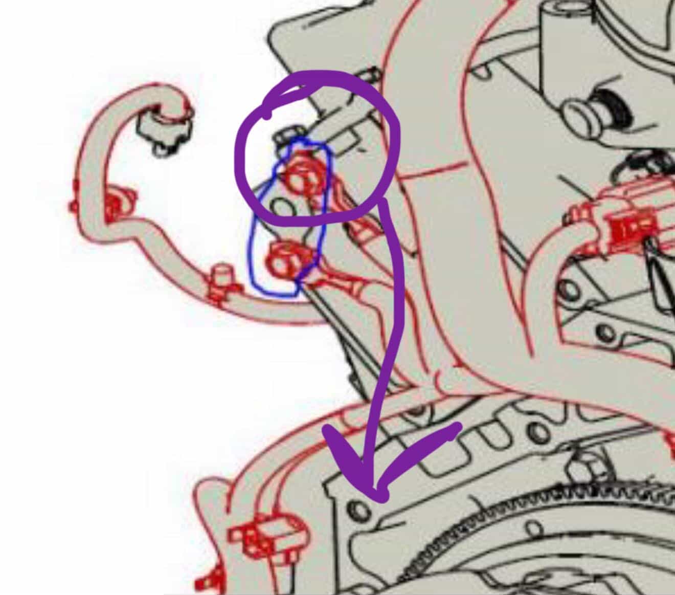

Hey all! I'm having a weird issue with my ZLE; as I'm driving down the road I am occasionally losing all power for a second or two before everything comes back on. When it happens, the gauge cluster shuts off, the lights shut off, the exhaust valves open regardless of whatever mode the car is in, and the EPS stops working (this is the most troubling part; quite dangerous).
My first thought was that a ground didn't get tightened properly during reinstallation of the engine after a complete overhaul. I checked the ground connection on the back of the passenger cylinder head and everything seems to be good there.
However, the back of the driver's side cylinder head usually has two ground connections, and I noticed one of them was relocated to the back of the bell housing (see attached photos, relocation shown in purple). I'd assume this is NOT my issue as there should be continuity between the bell housing and the engine block, right?
I'd like to mention that the battery is brand new (OEM), and the passenger side wiring harness is safely tucked away from the headers and appears to be in perfect condition.

Have you checked all the battery bolts on the underhood and positive post junction blocks?

If you just got a engine overhaul done and are having electrical issues, then there is a very high probability that something is loose.
Hell there is even a chance that a fuse isn't fully seated if they pulled something prior to removing the engine and just never got back to it or halfway did it.
Relocate those grounds back to the cylinder head. You want to rule out a 1000% clean connection to the engine block as there is a lot that rides on those grounds and continuity through the bell housing is not where you want to be in that situation. If the issue persists then start by checking all fuses. Move on to all termination/ connection points from there if necessary. This is going to need to be a methodical inspection for you if you hope to figure this out.

Thanks guys! I'll start by relocating that ground to the back of the cylinder head, check the aforementioned connections and go from there.

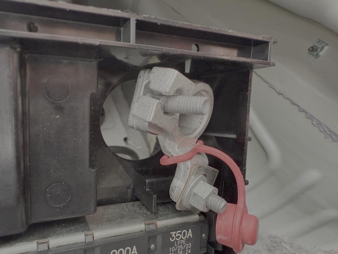

All,
Happy update time! I double checked the obvious at the battery terminals, and it turns out I had a loose connection on the positive terminal. I thought I was good from when I checked it before because the bolt was tight, but it turns out the terminal itself was stretched so it wasn't making great contact even though the bolt was tight.
Went down to the dealer on Saturday morning, replaced the main fuse that sits on the battery (I figured I should probably do this instead of just replacing the terminal as I had snapped some of the clips from the last battery change, and it's cheap enough); driven the car since then without a hiccup.
