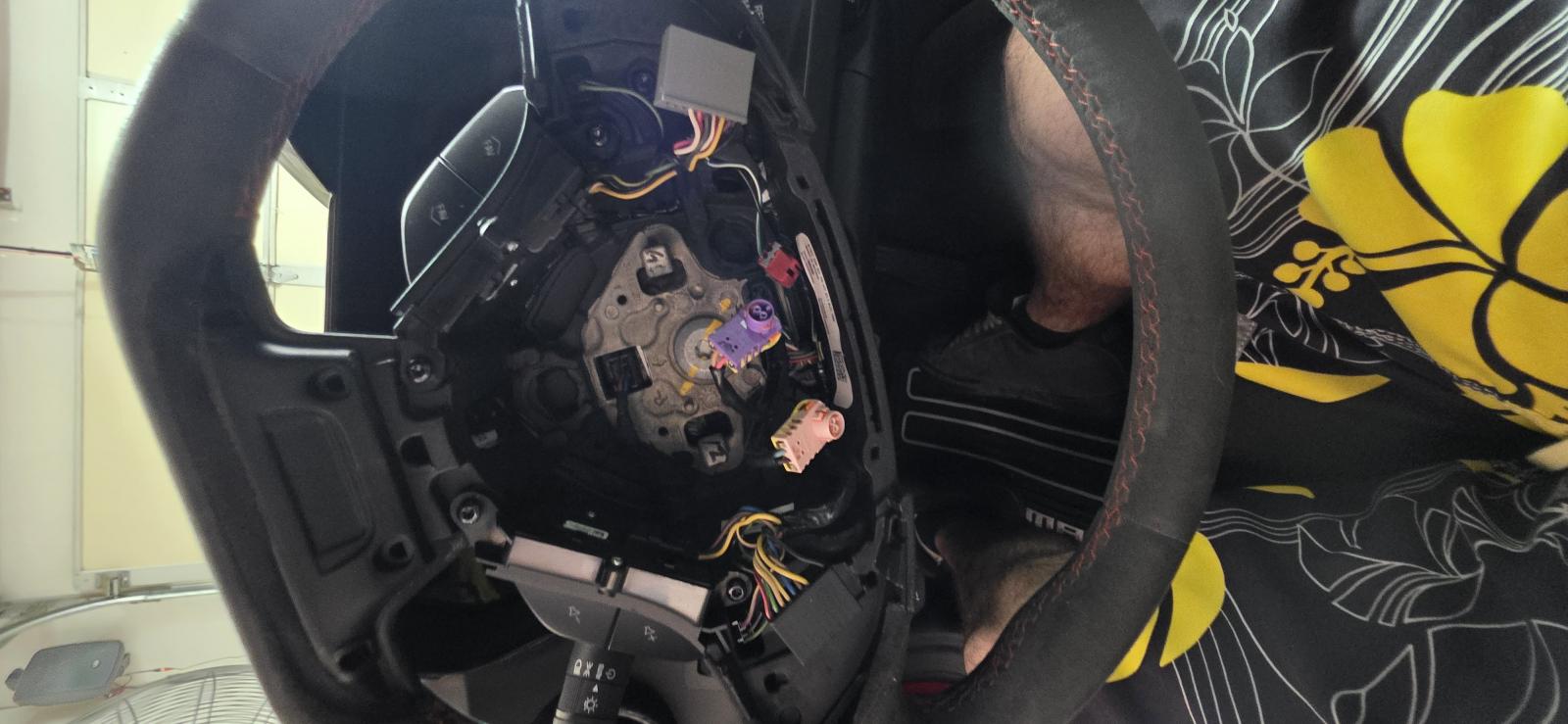

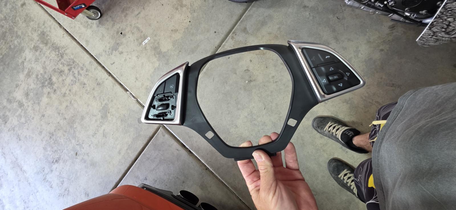

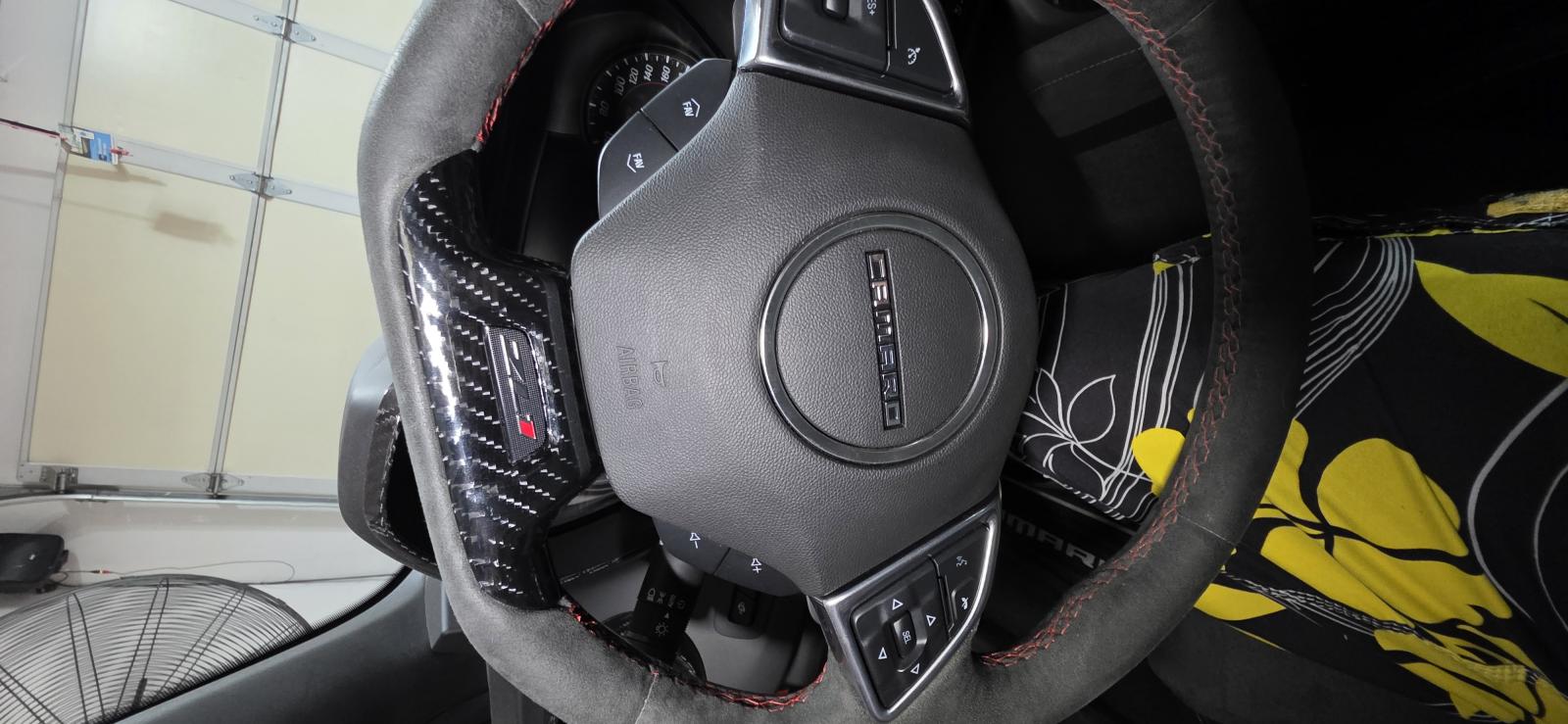

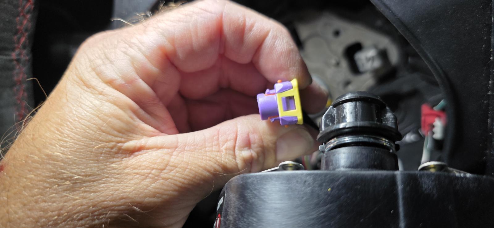

I also replaced my cruise control switch today. I was very nervous at first, but tbh, it was actually pretty easy. I had to completely disassemble the switch to remove and install the new one. Also wrapped the bottom of the steering wheel,(which had bubbles) with a carbon fiber wrap. Just wanted to try it out as most carbon fiber wraps dont look very good. It surprisingly turned out pretty good. Obviously not the real thing but close, it shifts with different angles too.

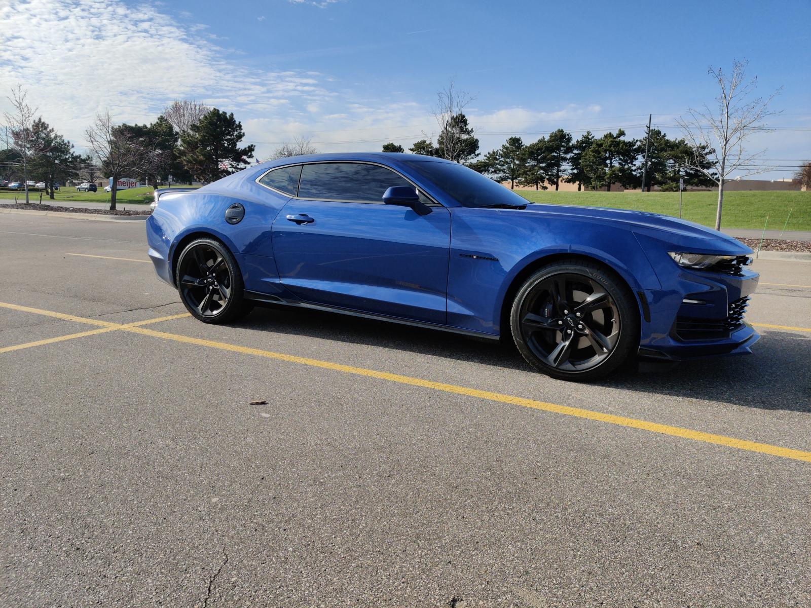

Finally got new tires mounted! Conti ESC02. Bye bye skinny winter wheels! Looks so much better. Now I need to wash it.

Love those wheels for sure. Looking good.

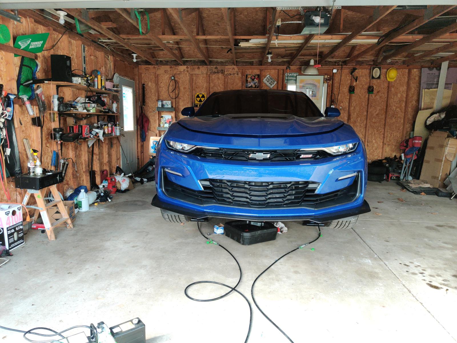

Pulled out of storage, did an oil change, and took her on the first drive of the year.

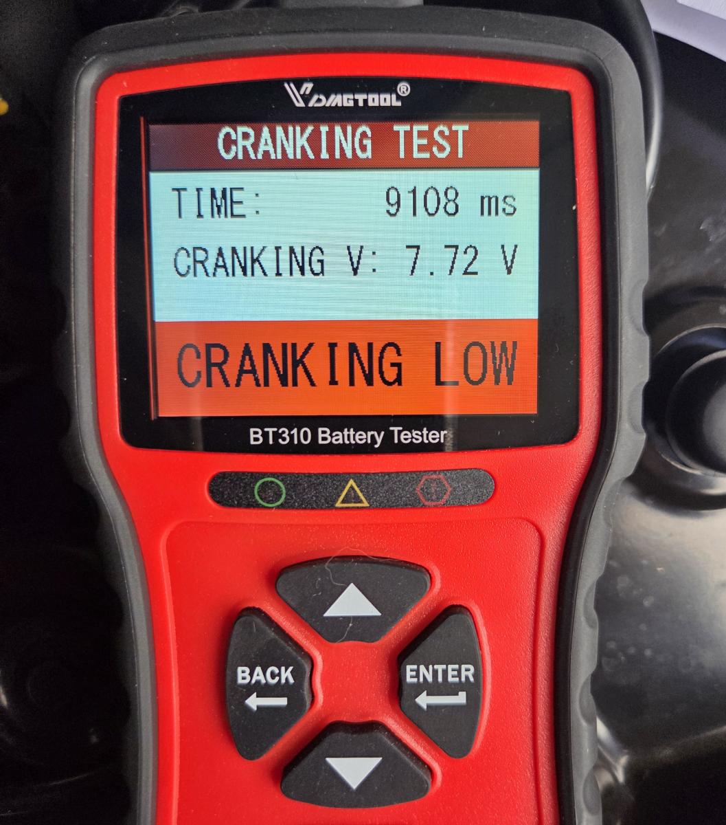

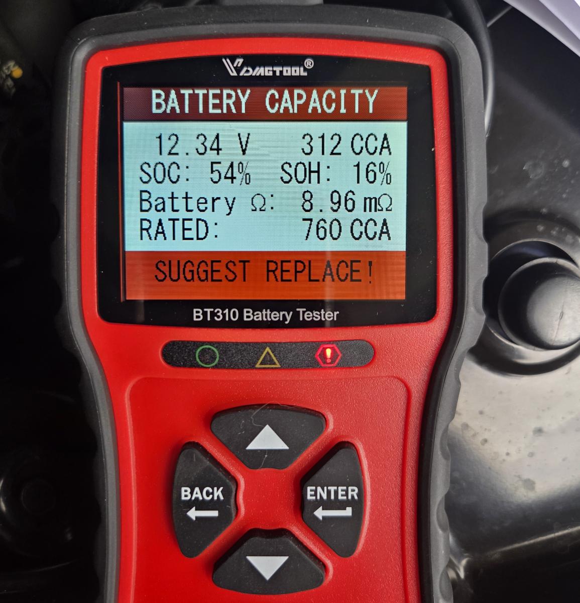

Decided I better order a new battery. Should come tomorrow. ACDelco Gold 48AGM.

312 CCA is bad, old AGM pack has to go. If it still cranked and started the car, you're lucky.

The recommendation I've heard is to replace the oil and filter before you put it away. Drive it a bit to circulate the new oil. Putting it away with used oil means that any acids, moisture, and sludge is going to be in your car all winter. I always winterize my boat this way. (Olds 455)

Starts every morning, even on the cold winter mornings this past winter. LOL. Also runs a 1000 watt amp & sub. I do put a charger on it quite a bit. But yeah, I think I'm on borrowed time.

That is good advice. I'll do that before storage this year.
