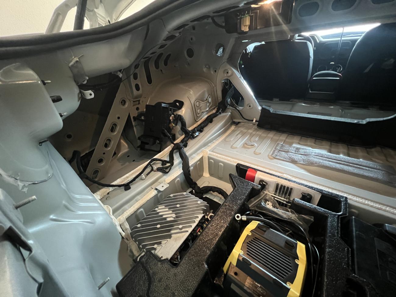

My rear seat belt area is making a really bad clicking/rattling noise. It’s not a super good video but it records the sound really well. Has anybody had the same issues and how did you solve it?https://youtube.com/shorts/GzKD93jzF...OOTXjM1JE8LVus

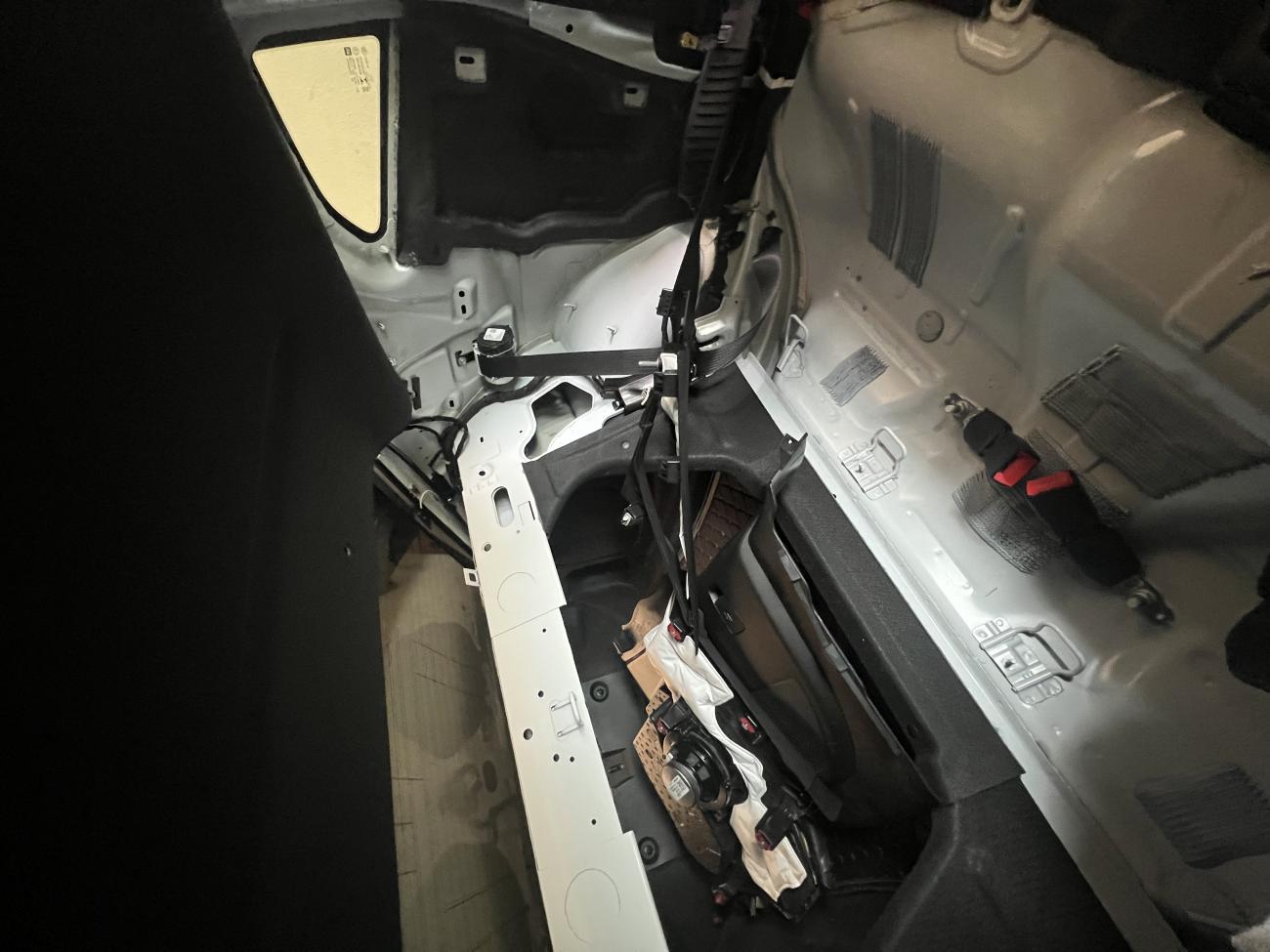

I basically removed all the interior today except the ceiling panel and the rattling is still there. I can feel it’s there but can’t locate it

I will try it, I rode in the back with all the panel gutted out, sounds like it’s from the quarter panel but there’s nothing there 🥲

Check for loose stuff under foam insert in trunk ?
