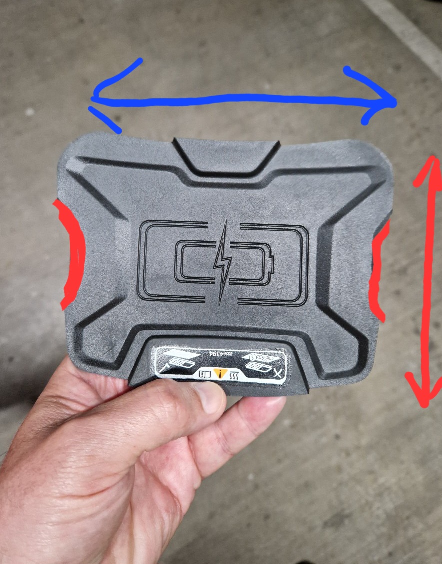

Originally Posted by Diggs View Post
Can you (or anyone else that saw this and has done it) be more specific about "these short edge cuts". I just got a 2023 2SS and my Samsung S24 Ultra doesn't charge on the pad.
Thanks.
Diggs
Blue is long edge
Red is short edge
I highlited the area you cut off

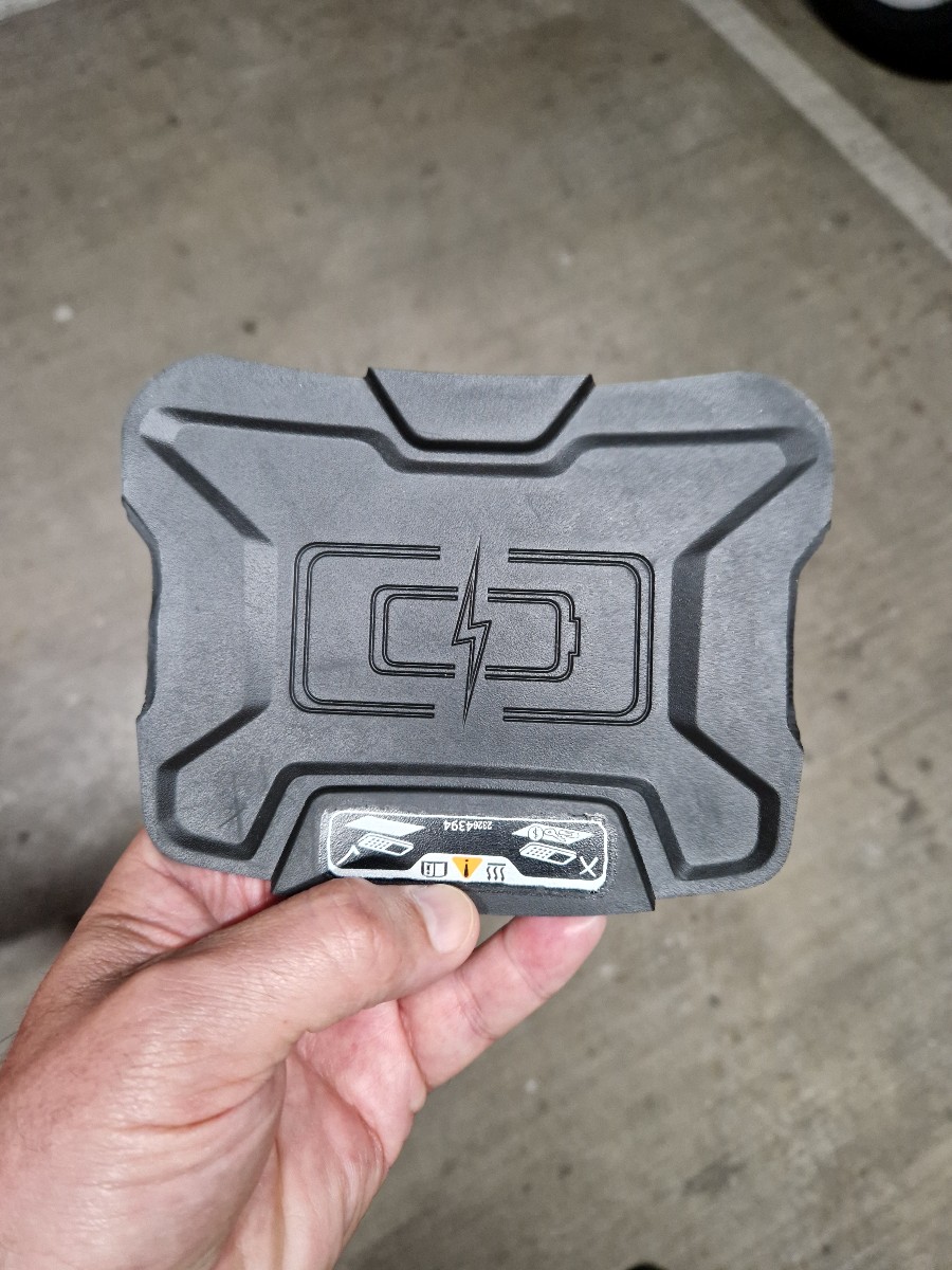

bishopts showed you the cuts, that's exactly what you need, but here is a photo of my pad as well. Make the same cut along the other short edge, too.
By the way, I recently bought an S23 and it fits, leaving an extra mm or two on each side even with the phone in a rubber case. Charging with the new (2019) upgraded wireless module is flawless, I get around 8-10% per hour while heavily using Android Auto. Win/win.
Off topic, but the radio in the S23 is an absolute pile, 8-10 dB less signal strength than the S21 in the exact same locations. I will upgrade to the supposedly improved S25 as soon as it drops into my price range, which is up to $199.99 . Oh, and that phone will fit the trimmed pad as well.

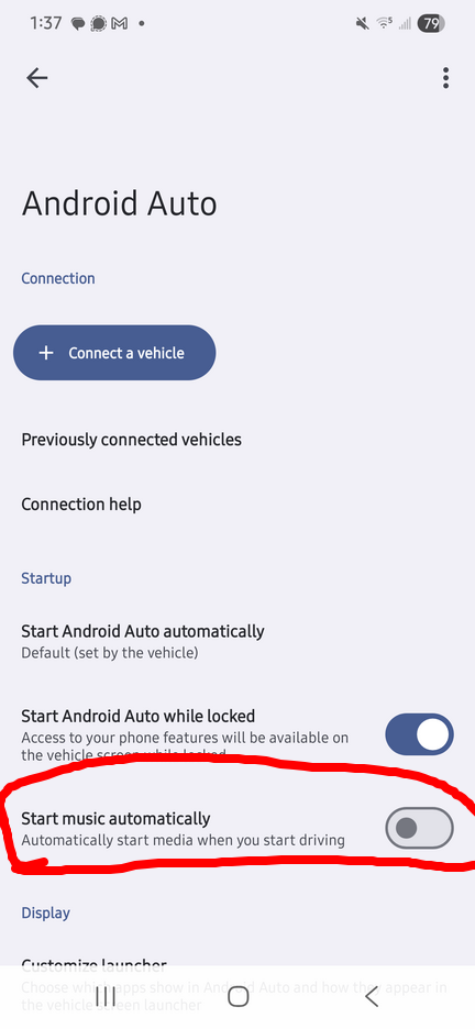

Is it normal for the car to start playing music before i have started it? I opened the door to put my son in the passenger seat and when i was buckling him up the radio started playing.
Old 03-12-2026, 12:43 PM   #54
Posts: 13,435
There's a setting in Android Auto for autoplaying media upon connecting to the car, see screenshot below. You should be able to turn that off on your phone.
(The Android Auto app on the phone is hidden for some weird reason, I access its settings via Apps > Android Auto > Configure in Android Auto, the last option at the bottom of the screen.)
