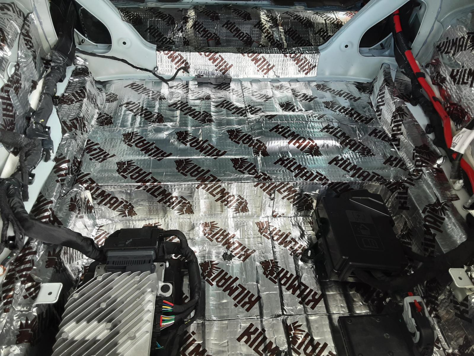

Info: WOW, did I totally remove that first seat 100% the wrong way (kind of). There are only two 15 size torques bit bolted that keep the seat bolted in. Then then the whole seat and frame work slide back about an 1", and the whole thing comes out together. Only need to disconnect the yellow electronics and airbag connector from under the seat and take a single bolt out of the seat bel support attached to the floor. The drivers side I took out the correct way!
Progress today should be to complete to roll cage install. I'm also installing Dynamat Sound proofing on all bare metal, seat self and flooring that I can. My car is much louder now that I have the seat delete kit installed.
I found the sound too loud also inside after putting on the AWE touring exhaust with the build I have so I did the same with Kilmat. Then in the trunk I put Dynamat over the Kilmat It made a difference but, no actual measurement. I can imagine the sound much louder with the seat delete. That roll cage looks awesome. Are you doing different seats?

Smoking19 - That is AWESOME!!! WOW You were able to cover a lot more than I was originally thinking could be cover! GREAT! I'm ordering more Dynamat to make sure I can do as much as possible. Thanks for the information and the photo!
