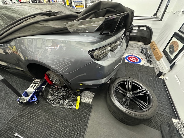

Started taking the wheels off and cleaning/inspecting. Drivers side done. Also ceramic coated the calipers and wheels.
Ryan
I just spent hours/whole day using iron remover by carpro and an apc to clean the rust from the pads off the drums. hosed em down, then applied a ceramic coating (carpro D quartz). Very happy with my application and removal. Did two applications on front and back on all 4 wheels. followed up with arpro reload to give them that extra shine. noticed they were still holding up from last summer so the new carport d quartz is my upgrade from quartz UK 3.0 and dlux. dlux was a pain and I wouldn't recommend it.

I just used the adams spray ceramic as thats all I had and with as dirty as the calipers/wheels get I will probably give them a good yearly cleaning. Got the remaining pass side done yesterday. The first startup and quick drive to reposition the car in the garage was nice. Come on spring!
Ryan
