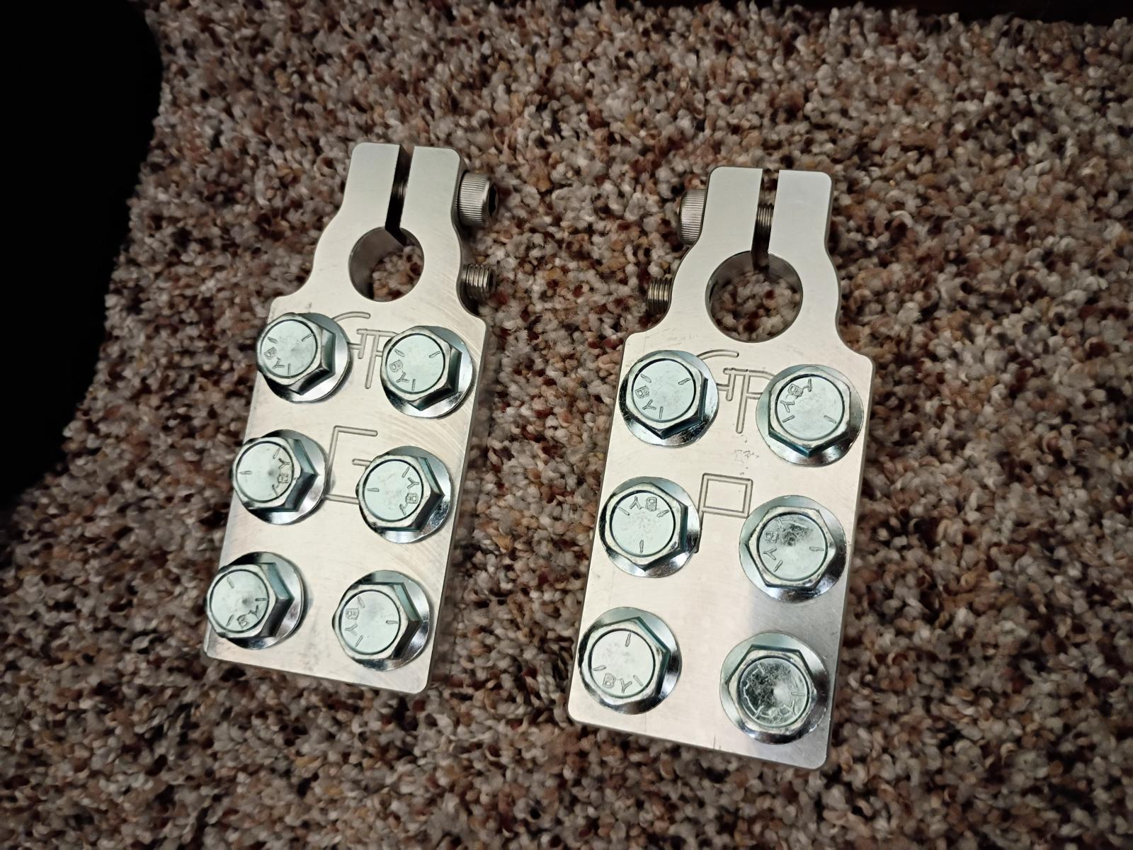

For the past 7 years every Christmas has been Camaro parts, gift cards for Camaro parts, Camaro signs, shirts, etc. 2025 was the Christmas of Silverado. My wife got me these awesome GP Audio battery terminals, if anyone has checked out my Camaro build thread, I'm big into grounds. I'll be following suite on this truck very shortly.

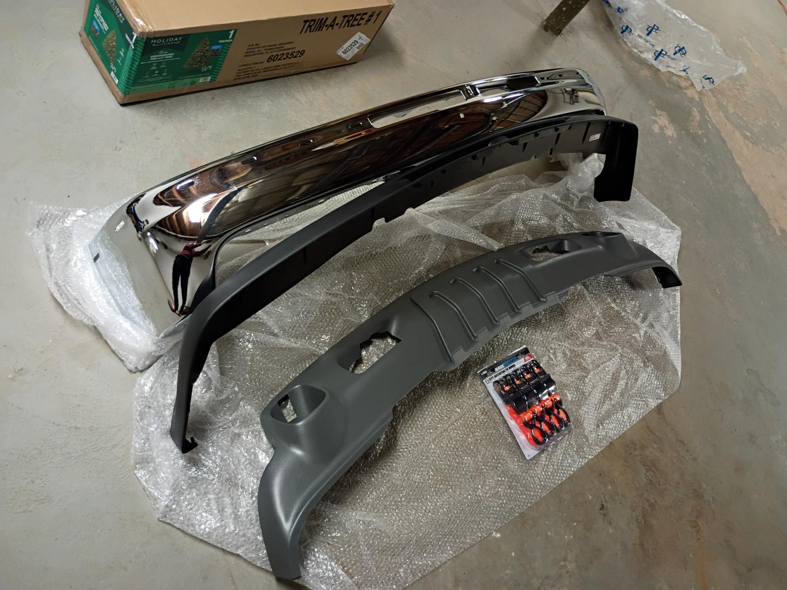

Dad hooked me up on a new front bumper and top cap assembly. Here you see a little preview of all my parts mocked up. I'm going to order all new bumper brackets, give them the battery tray treatment and get this installed. Might run like shit but man that chrome will be shinin'

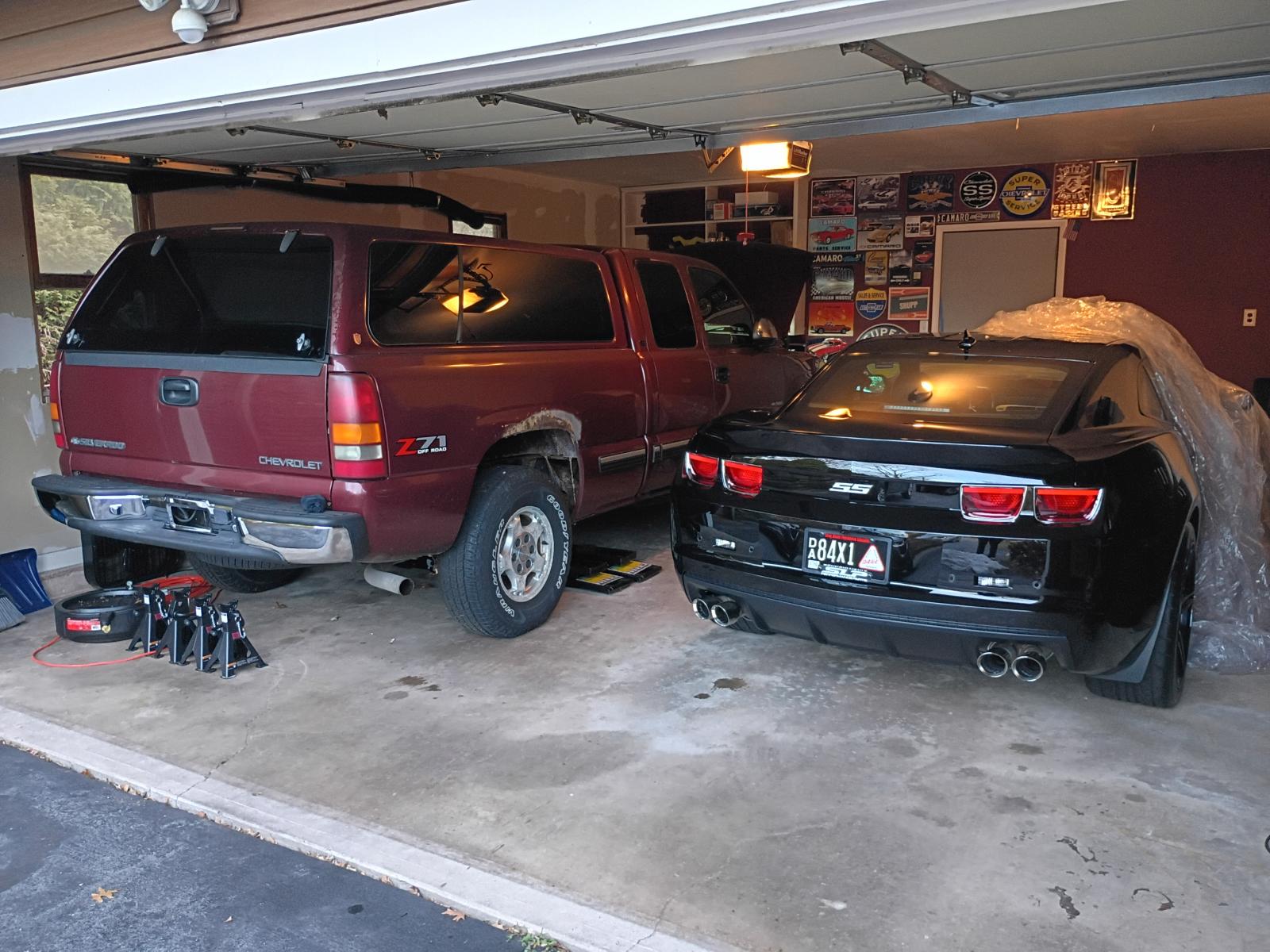

Also grabbed this photo of both Chevy's running together, I filled the Camaro with Stabil and was letting it run through the system before the goes under the cover till spring. I truck was running for a fuel pressure test. More on that in the next post.

In the meantime I dicked around with my new terminals. Installed them, made the stupid decision to cut the battery handle in the name of aesthetics and ran my first ground wire to the driver side head, exactly like I did on my Camaro. Most LS heads have an unused bolt hole that is perfect for a ground.
I'll make a few more runs of ground to the frame, rad support and fender. I'll run a power lead right from the alternator to the battery, obviously power will be distributed from there. Should look clean when complete. Busy, but clean.
