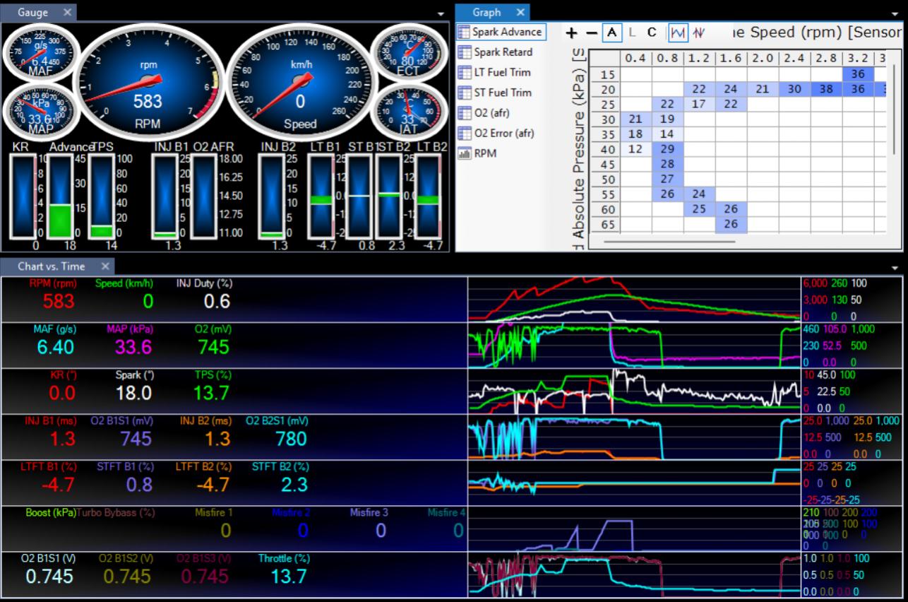

A quick updater about the SC issue.
I logged a couple of runs using mpvi4 and found that there are misfires on cylinders 1-4 with #3 having most of the counts.
MAP is maxed at 24 PSI!!
I am afraid that there is a ground issue not an engine issue.

Looks like 33.6 kpa
