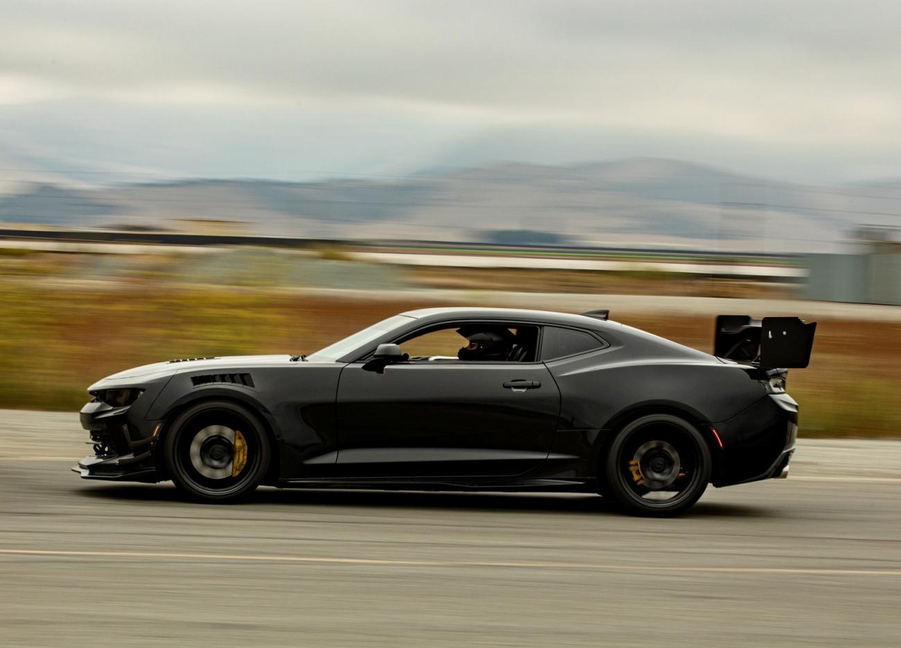

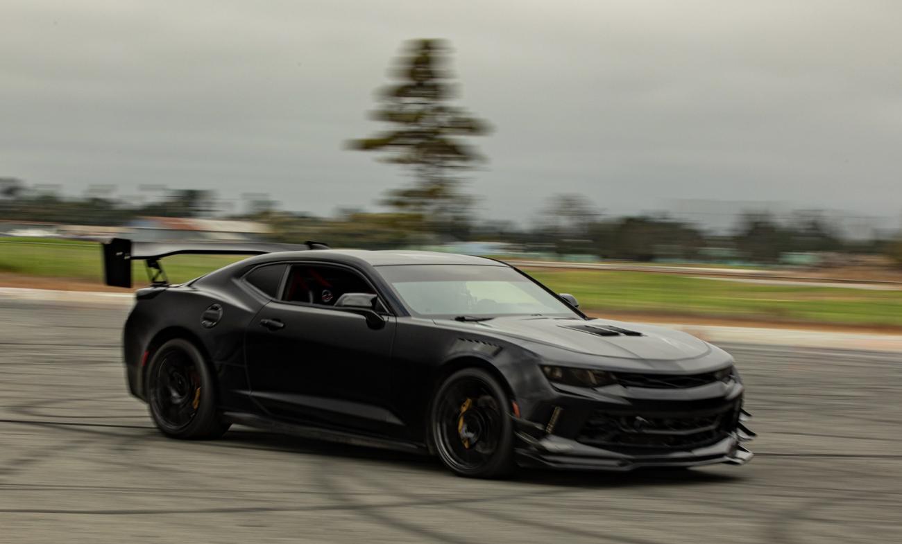

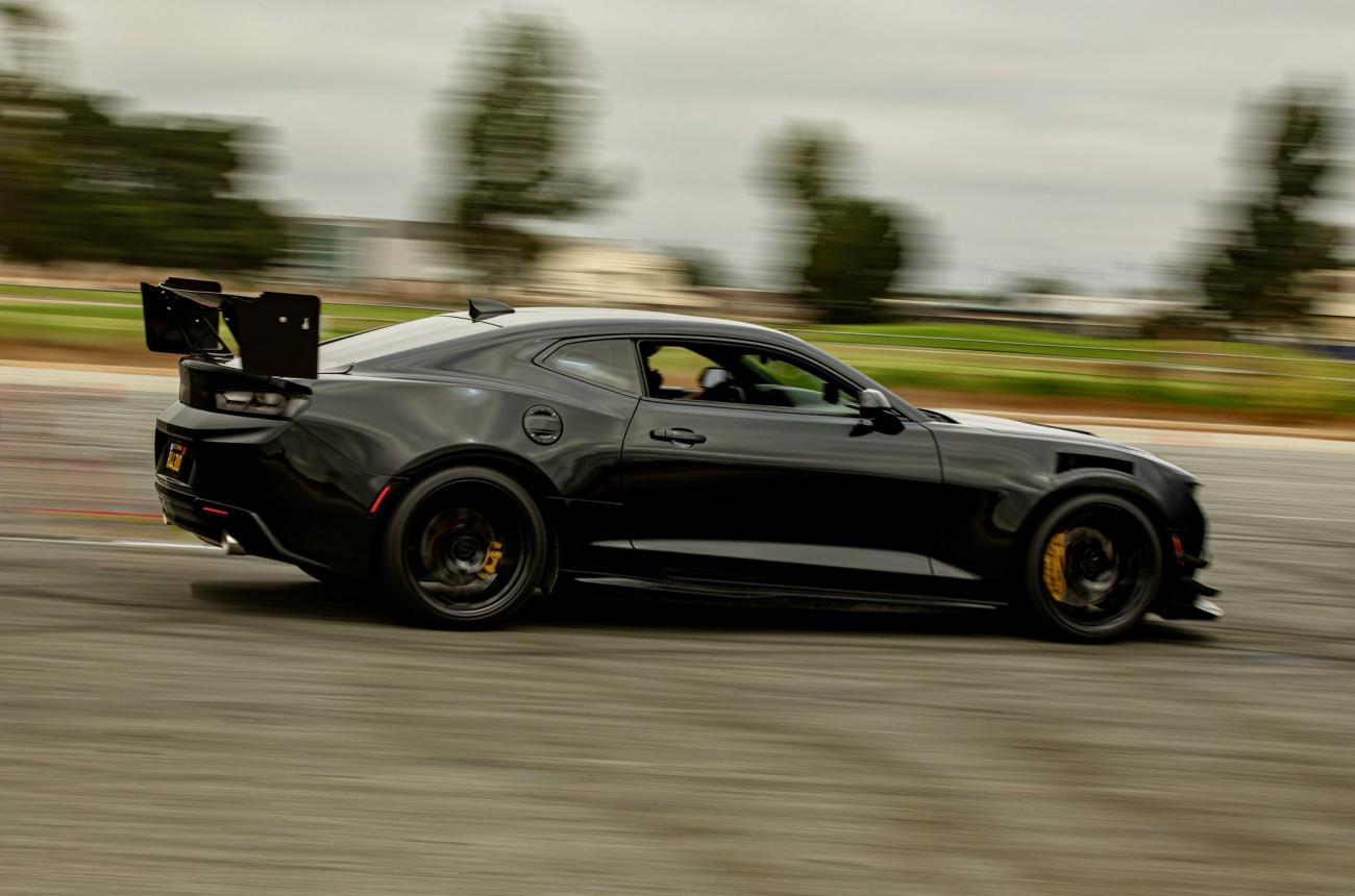

Some photos from last weekend with the BMW club
