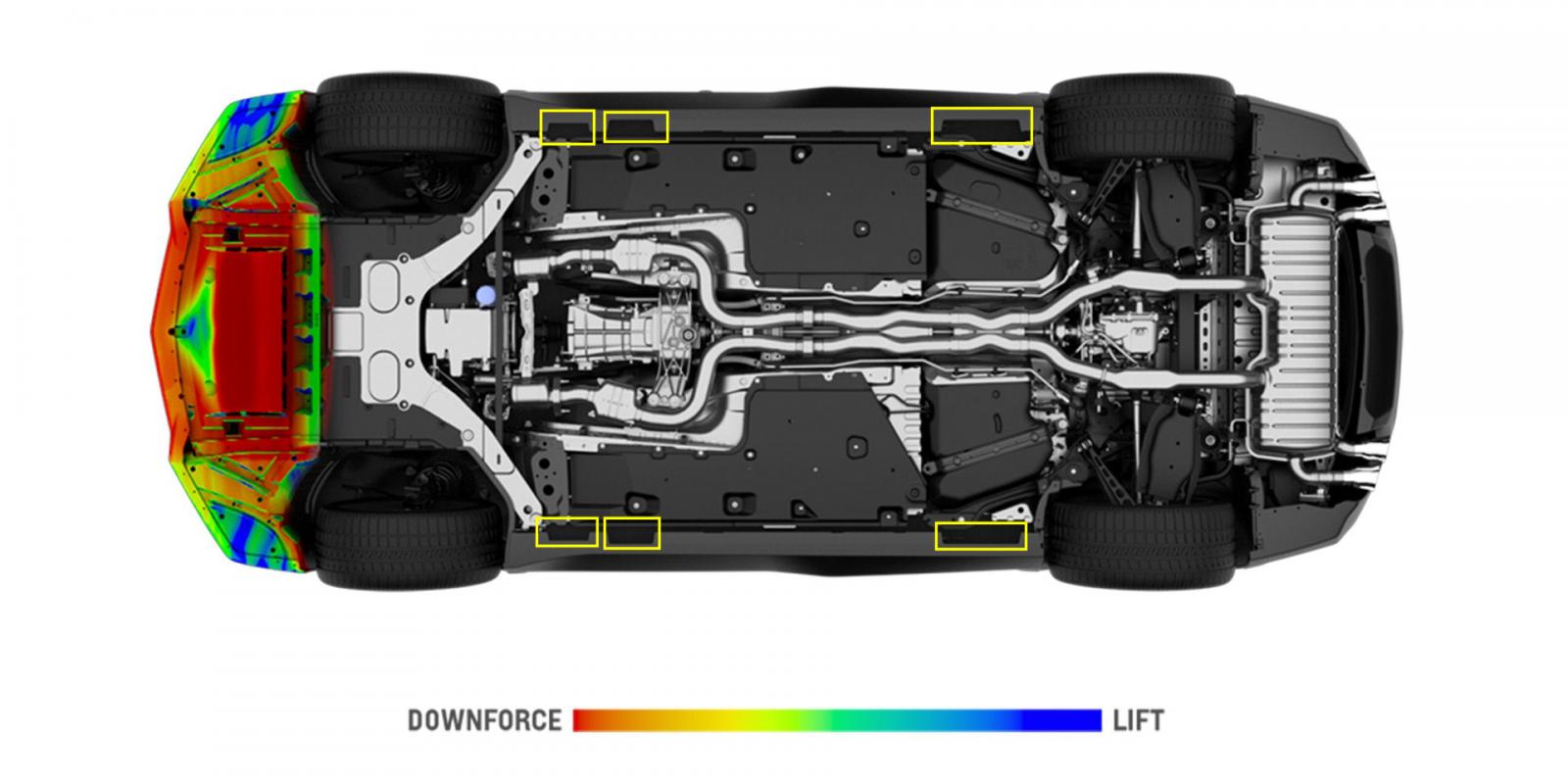

This is one of the pics floating around. I think there's a better one showing more jack points as well.

As bishopts stated, you can lift from the center jack point, which will raise the entire side of the car, because the chassis is very rigid. You can then slide in your jack stands under the rear and front lift points, release the hydraulic jack, then repeat the process on the other side. You can do this in two stages, too, if you don't want to fully lift one side first, as it may feel scary.
Here is the official jacking guide from the service manual, see my red arrows indicating the center lift point on one side.

I found a service manual. It doesn’t show the center one for the convertible.
