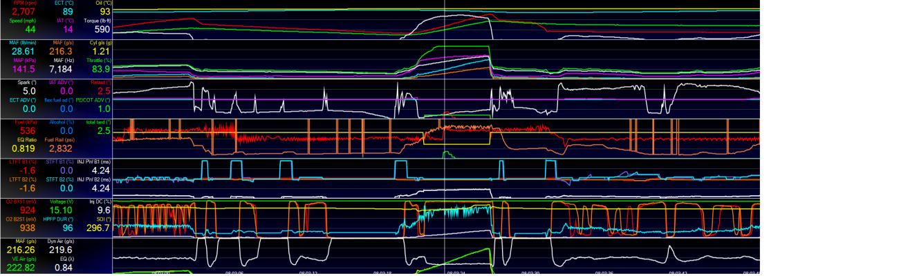

OK. Well, if you can look at a WoT pull, lets take 4th gear as an anchor, somewhere between 4500 - 6000 RPM. Have a look at Spark advance, AFR range. Would be interesting to see the data.
Small snip of a very short 4th gear pull this morning in the zip file. File size is very limited on the forum.
Timing is extremely conservative (imo) and still getting some knock down low, which is looking more and more like blower or header noise to me than real knock. BUT - I'm a turbo guy, and this platform is still foreign to me. Running 93 and have added boostane to see if it eliminates it - it does not. Screen shot of a different pull - can still see the light KR in the same region. I assume the knock learning will eventualy nip this, but dont know for certain. Any advice to diagnose would be appreciated.
Going to hit the dyno tomorrow to get some reliable 4th pulls. Will be getting a wealth of data from those runs, naturally.
That said, depending on the situation it's somewhere around 8-12 degrees in the suggested rpm range.

Cool. I will have a look at the log later.
KR is often dependent on the KR sensitivity settings in the tables, so mechanical noise can indeed casue this.
Tomorrow at the dyno, it is a good opportunity to run a complete log and cover all of the parameters. If the dyno shop is using external professional Knock sensors, I.E. Plex https://www.plex-tuning.com/product/knock-detection/ then you could find out if it is real or fake.
The OEM sensors are not quite as accurate as Plex.
Will you have your remote tuner standing by in the background, or even monitoring your session at the dyno?
This could prove effective because he will able to calibrate in RT while seeing the results.

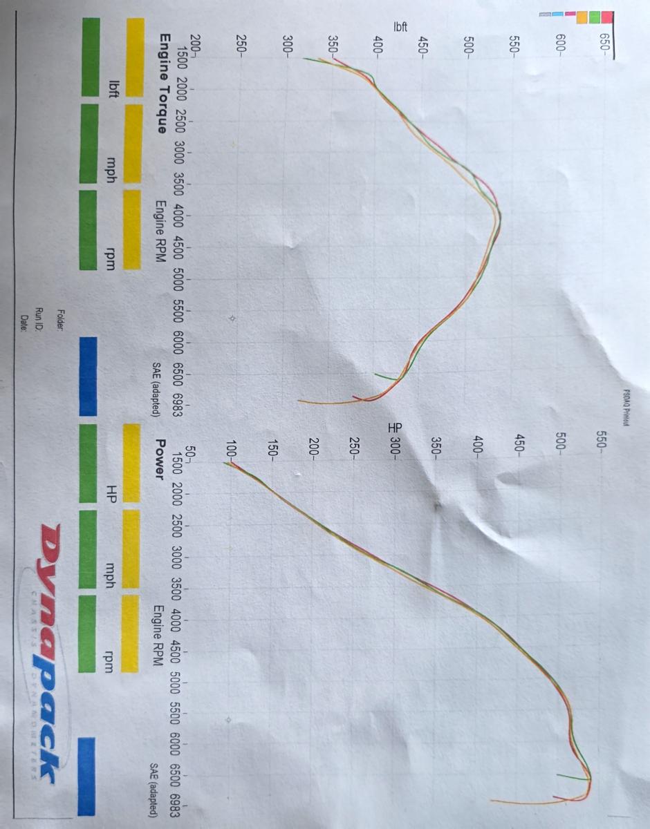

Had a look into the log. Found peak Torque at 3800 RPM 884 Nm (652 Pounds) at the crank. Boost at this point is 7.5 PSI. Spark Advance extremely conservative at 8.0 Deg. Lambda 0.82 - rich enough.
At the wheels this torque level would be 554 Pounds (15% Drivetrain loss for Auto).
Interesting if the dyno shows similar figures.

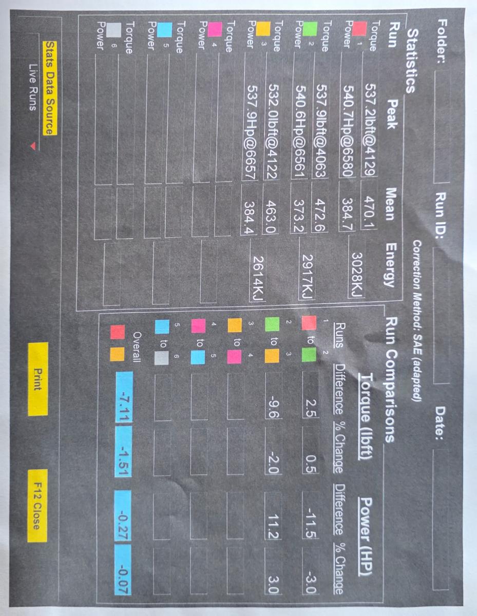

You weren't too far off.
540hp/537tq on a Dynapak setup.
No changes made during the session, just back to back runs.
She was running a bit rich. Boost crept higher than I expected, but I have read that it's common. Tune by Ted (JRE) remotely and only on the street. Not too bad for what it is. Repeatable, IAT's seem reasonable and lots of area under the curve. Funny little dip towards the end of the curve, not sure what that's about.
Anyways, it certainly feels like it's got more in it, but I'll defer to Ted when we talk next week.
Graphs and log attached.

Great! This leads to the conclusion that HP Tuners logs provide an excellent prediction of what can be expected on the Dyno. The Torque results seen on the Dyno in your measurement are only 2.5% off (lower...) compared to the HP Tuners .hpl.
Would be interesting to get such validation (or refute) from others who logged torque and dynamic MAF / Airflow and compared to the dyno results during the same run.

...And another piece of important detail picked up from your dyno. This was a DynaPack, meaning, that the measurement was right at the Hubs and this means the most conservative numbers possible - lowest parasitic losses.
Guess that a Mustang dyno would tipically show ~ +3-5% higher readings than a DynaPack (like you measured on) and a DynoJet would show the highest numbers overall with ~ +10-12% compared to DynaPack. Makes sense?
