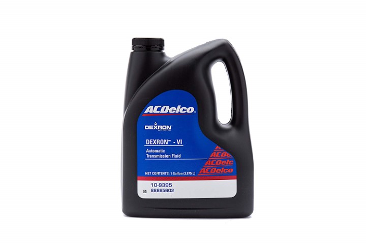

FLUID: DEXRON VI automatic transmission fluid, ACDelco 10-9395 or equivalent (the SS w/ Tremec 6060 uses manual transmission fluid, the 3160 uses ATF).
FLUID CAPACITY: 2.7 liters (reference: Tremec 3160 specifications PDF, see attached below)
