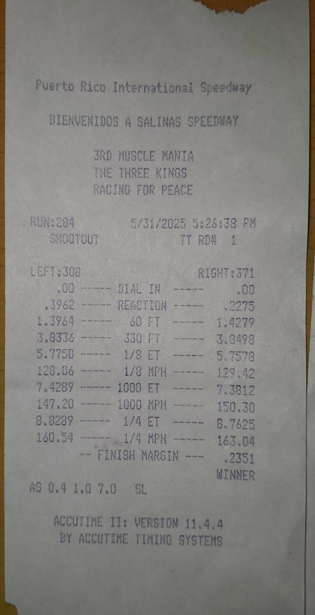

I would like to improve my 60 foot to at least 1.34. I am doing 8.82 @ 160.5mph with 305 45 r17 Mt tires. I wondering if there is a better tire in 17 inches. Example the hoosier 28 X10.5 r17 or the MT Pro?
The car is 2017 zl1 1100whp

What is the car doing? Just spinning? tire shaking? The mph does suggest there's more room in the 60'. Whats the whole setup on the car?

Car is spinning the tires, I remove a lot of power to be able to do 1.39. Full build engine and transmission with a 2650 and supporting fuel system.
Have you tried 2nd gear launch and putting power back in?
I pull timing in the low to mid range to help get my car to hook out of the hole. Is that what you’re doing or limiting boost in lower gears?
I have to pull timing AND launch in 2nd gear FWIW.

I am doing 2nd year, limiting low end power. That is how I do the 1.39 60". Currently using the mt et street R 305 45 r17. I wondering if there is better tire but in 17 inches to add more power out of the line. The car with the power it has should be doing 8.5 to 8.6.

Maybe @ZL1Atlanta will chime in. He’s running 1.22 60’ times but believe he’s on 15” drag radials as well.
Other option is to talk to Kelly at Kelltrac. The man knows how to get modern muscle to hook off the line.
