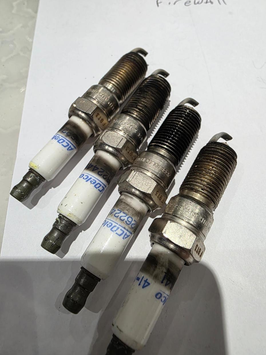

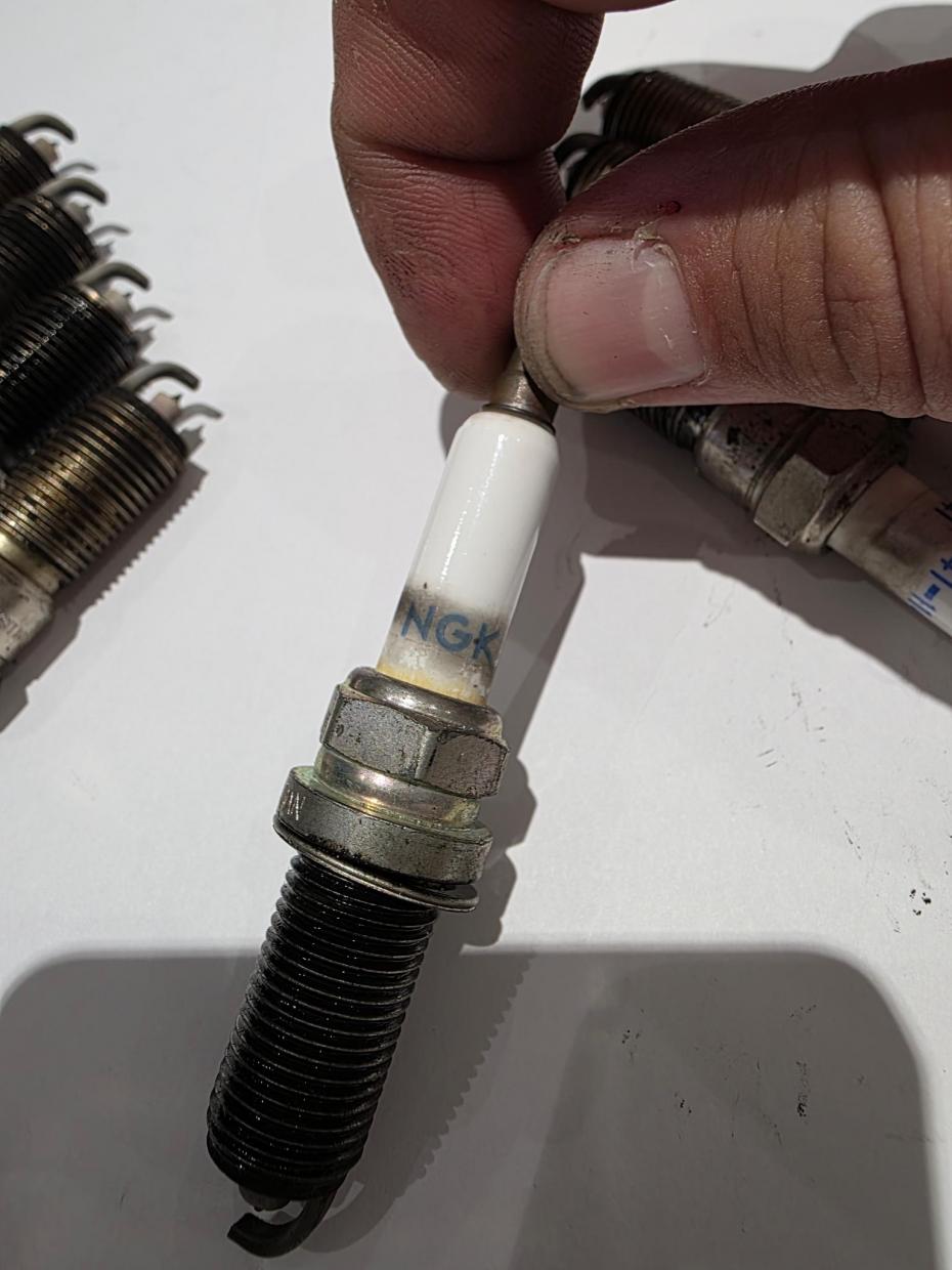

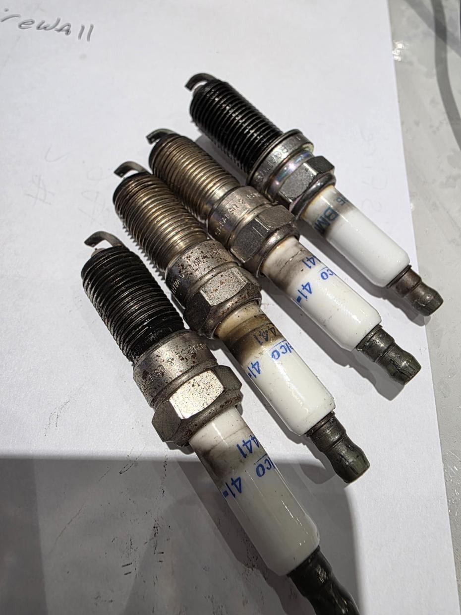

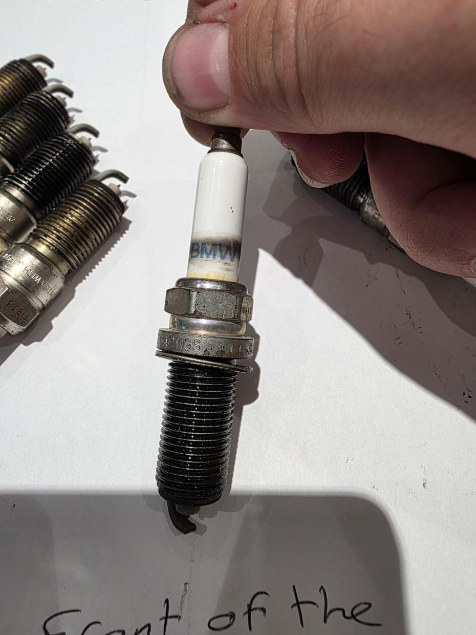

I just changed my spark plugs today and noticed that some were a bit wet and black. It might be my E85 tune that needs adjustment . I also found that the spark plug in cylinder 7 is a BMW/NGK plug, suggesting someone previously serviced my car and replaced it
The #7 spark plug seems more worn than the others. What are your thoughts on this? I guess if I follow some logic, it seems like the issue could be with the injectors or coils pack, but it’s strange because I don’t notice any misfires in HP Tuners.
I only see one or two misfires counts when I rapidly press the gas pedal consecutively (kinda like repeatedly tapping a keyboard hotkey quickly), but they disappear immediately and I don't even feel it.

That plug can't seal on the head correctly. The flat collar with a gasket is designed for a flat surface to seal against. The others are a taper collar that seal against a taper surface

Were they all tight? Some are carboned all the way up the threads... Wrong plug doesn't help either.
I gotta say, it wasn't really hard to unscrew it compared to the other ones..

Some were pretty tight and I had to force to get them out and some I didn't have to force much to get them out..
