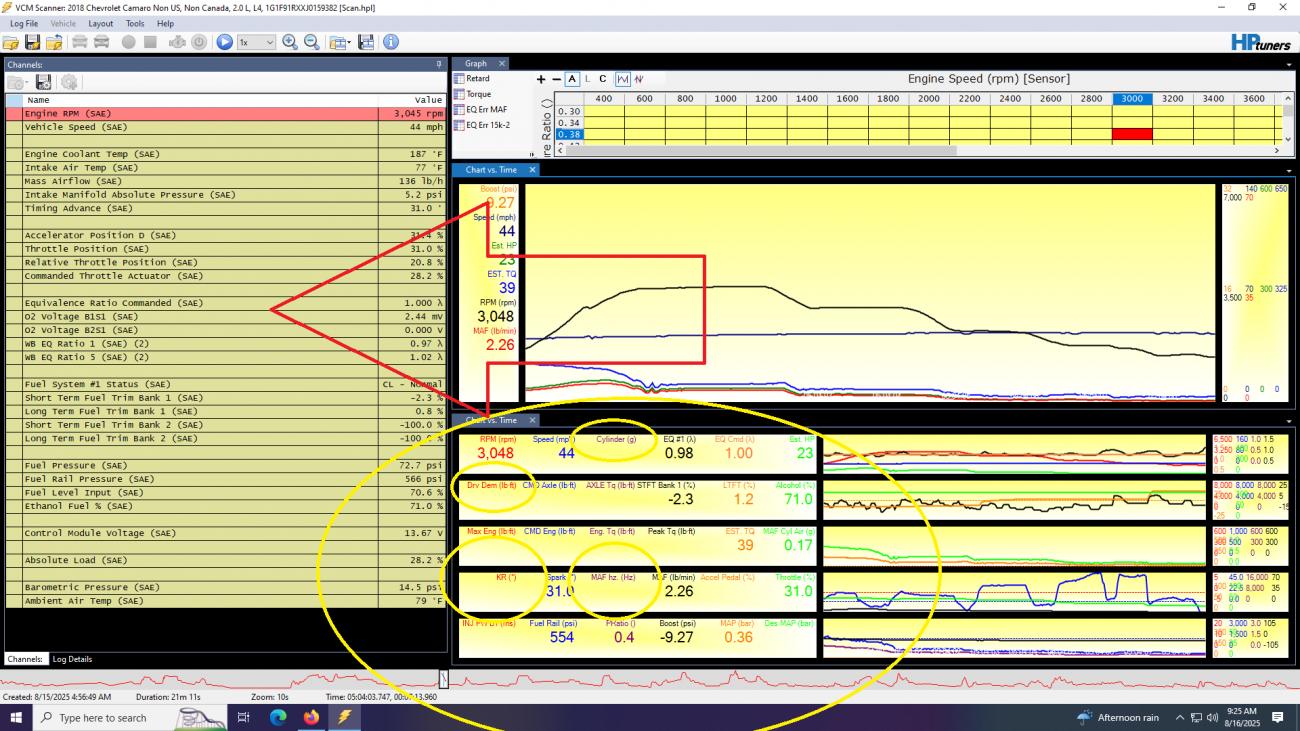

I have a friend who wants to do it, he asks me to add channels like in this photo, I have an xml file is it the right one, are the channels added?
