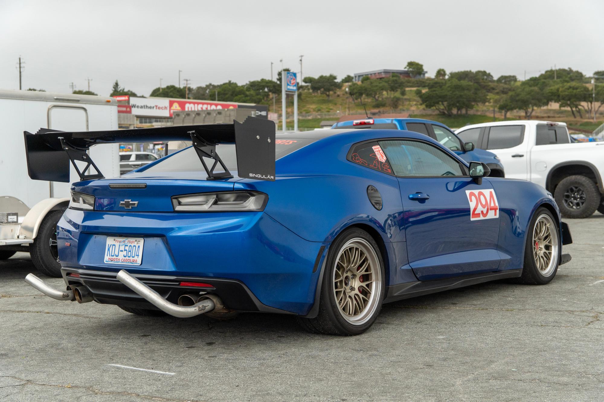

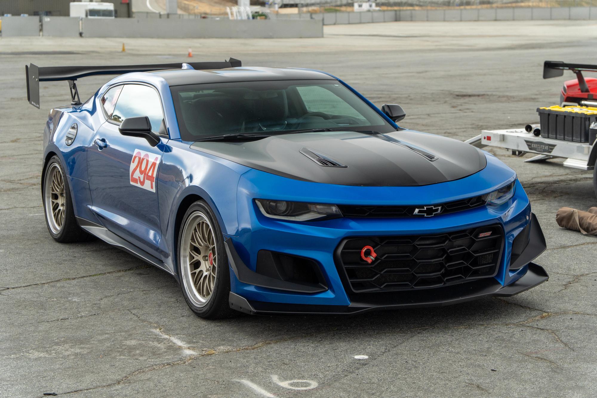

Check out this 6th Gen Camaro SS rocking 19x11 ET44 ML-10RT Machined Lip Gloss Motorsports Gold, wrapped with Goodyear Eagle F1 305/30/19's all around! This requires 30mm spacers but works as a square setup for track customers trying to get longevity out of their tires!
Click here to buy the same fitment!

I love my set of Apex wheels. i'd like to get another at some point. However, you no longer make 19x11 ET35 which worked perfectly as a square setup when combined with 26mm spacers up front. You now only make ET44 which creates a tuck in the rear. Plus, to clear the front struts, you need at least a what, 1.5" spacer?
The reason the ET44 works above is because he's on ZLE DSSV shocks. I think it was a mistake to move away from the 35 offset.

I think you can still get the 19x11 et35 is certain wheel versions but they don't offer it on the ML-10s unfortunately, that's why I went with the above setup which is a rear BMW M3/4 spec. And I should add that I only use a 25mm spacer so if you grind down the strut and also run a Magride compatible camber plate you can probably also make this setup work on a "stock" SS 1LE with a 30mm spacer.
