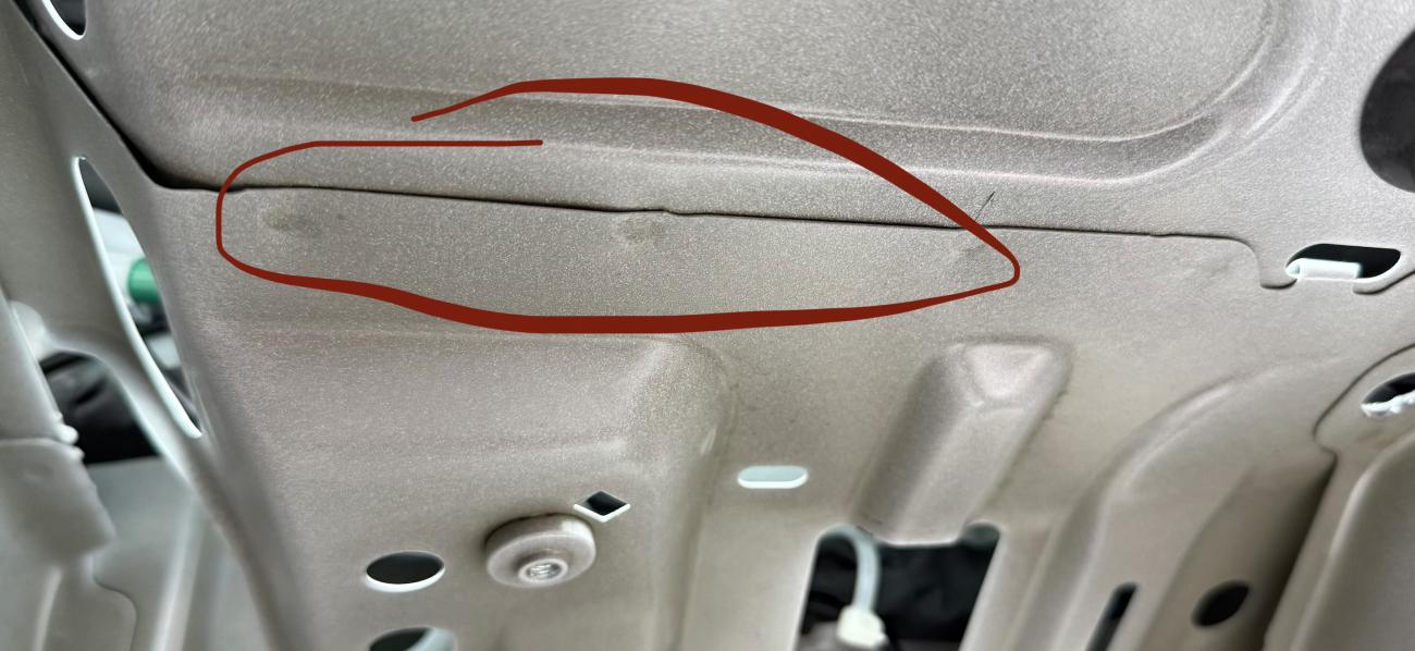

Appreciate the help, one (hopefully) final update.
It wasn’t the screw itself, rather the sheet metal that’s vibrating causing the ticking noise. (I tried a star washer on the bolt first and electrical tape with no luck then went back under to see again)
I was able to make the ticking noise by pushing up from beneath at that certain area. Didn’t happen pushing from the top and if I held the top it wouldn’t make the ticking noise.
After some deliberation, I settled on hammer first then silicone RTV if that didn’t work.
I hammered these two sections with a small hammer, not enough to make impressions or dents. (Will take after photo once it stops raining)
No more ticking.
Attachment 1166155
No more ticking.
Nice effort to find the elusive tick.. I wouldn’t have gone that far to find it. But, if mine starts to tick, that’ll be the first place I’ll look. Thanks for sharing.
