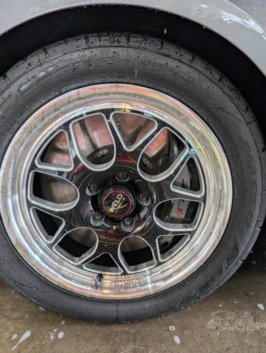

I washed my car yesterday. Attached is a photo during washing and after spraying Hyde's Rust Stopper on the rotors, then a photo from this morning before driving the car to car's and Coffee... NO RUST !!!!!

Thank you…the pic from today looks great. I can’t thank you enough for the help…greatly appreciated
