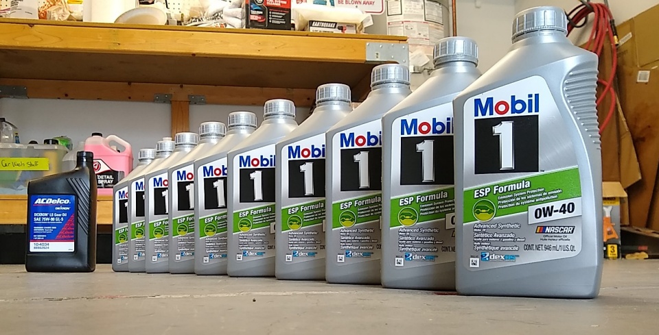

At least they got some nice "fresh" (6 month old) oil with a whopping 450 miles on it...
I have heard long oil change intervals (lots of miles, etc) are a big problem with the AFM/DOD Lifters... This car has never had oil in it longer than 2,500 miles or so (once), most other changes have been far shorter... (505, 1,500, 4,000, 5,975, 7,800, 9,468, 10,785 miles)... This car is currently at around 11,200 miles and has had 7 oil changes so far... (not to mention 4 differential fluid changes at 505, 1,500, 5,975 & 9,468 miles, all with GM OEM fluid) Every single one with Mobil 1 0W-40 Dexos 2 oil...
My Motto...
"Fluids are cheap, components are not... Do the labor yourself, at least you'll know it is done right..."
