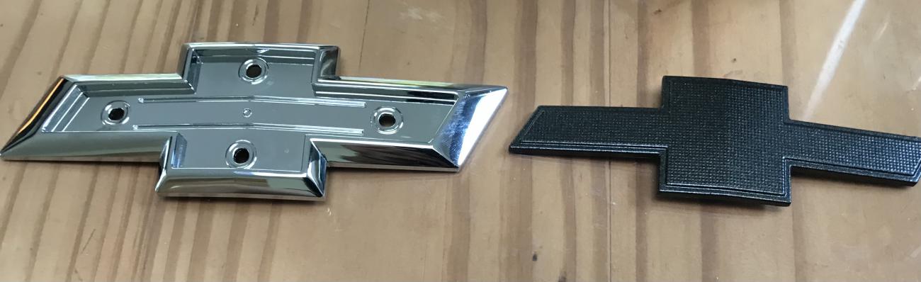

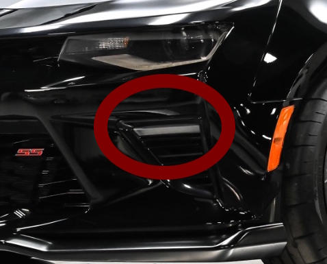

I've been on a slow journey to de-silver/partially blackout the exterior my 17SS. I've de-badged and re-badged with both black badges and custom-painted (by me) others. The last two items I'm scratching my head over are: the front bumper grill vent's silver bars (see pic - on my 17SS the bar right under the light is silver) and the silver outline of the two bowties (front and rear). I don't have recent pictures of her yet with all my cosmetics (I will soon..) but my main theme is black and purple (grape).
I was hoping to take an easy route for the grill vents; as an example I found some super easy interior AC vent rings that just 3M-adhesion onto the stock 'rings'. I was hoping to find 3M-ons for those vent silver parts, but grape color, but I can't find anything like that. Closest thing I've found is the several "use this vinyl tape, and cut off the excess" vinyl kits that I've tried for the bowties but since I've had ZERO luck there I'm not gonna waste the time/money trying them on these grill vents. I guess at this point: buy some metallic/glossy Grape paint (and maybe some clear coat?) and paint over them? Suggestions?
Speaking of vinyl tape kits... I have tried three different vinyl kits for my bowtie. Not only do I suck ass at "use this blade/exacto(r) knife to cut the shape of the bowtie out of the vinyl once the tape is on", but the vinyl never sticks - my 17SS bowtie interior is textured. Honestly, I'd like to keep the black interior and have the silver part be grape/purple. But question A) I'd have to remove both bowties: one, how does the front one come off/go back on, and two, I can take the back one off easy but suggestions on re-application - literally just buy some standard 3M tape? And question B) how in the eff do you 'tape off' the interior so precisely so as to properly paint that exterior without the end result looking like butt -OR- am I thinking about this the hard way, does anyone know a better solution?

I installed black Screaming Chicken vinyl covers on the small grille chrome trim back in 2020, they're still perfect. You can paint the vinyl before installation, but they already offer a wide selection of colors, you may be able to find a close or even perfect match.

As for removing the front, there are a few video on YT about how to do it. Mostly the same technique, but some are a little different. I was going to do that soon, but haven't yet. ....I'm with arpad, just take your time. You could always paint the WHOLE bowtie one color, then tape the outside and then paint just the inner bowtie part. This way you never have to stick tape to the textured part.
For the back bowtie, yes, just buy some 3M tape from the parts store or lowes/HD.

I ran into the same problem with the front Bow tie (paint sticking to chrome). Tried to remove it, but no go. I could see the tabs, but they weren’t moving enough to release. I was using some pretty decent leverage / large screwdriver (I have a LT1 front end). I gave up on the front (at least for now). Here’s a pic of the rear bow tie de-chromed / center section painted. When removing the rear bow tie, be careful.. the chrome edges are sharp ans hell and will dig into the paint if lifted improperly.

So I'm gonna give the screamingchicken vinyls one try and see how it goes. If those suck/don't stick/don't last, I'ma figure out another way to handle those silver parts under the lights.
