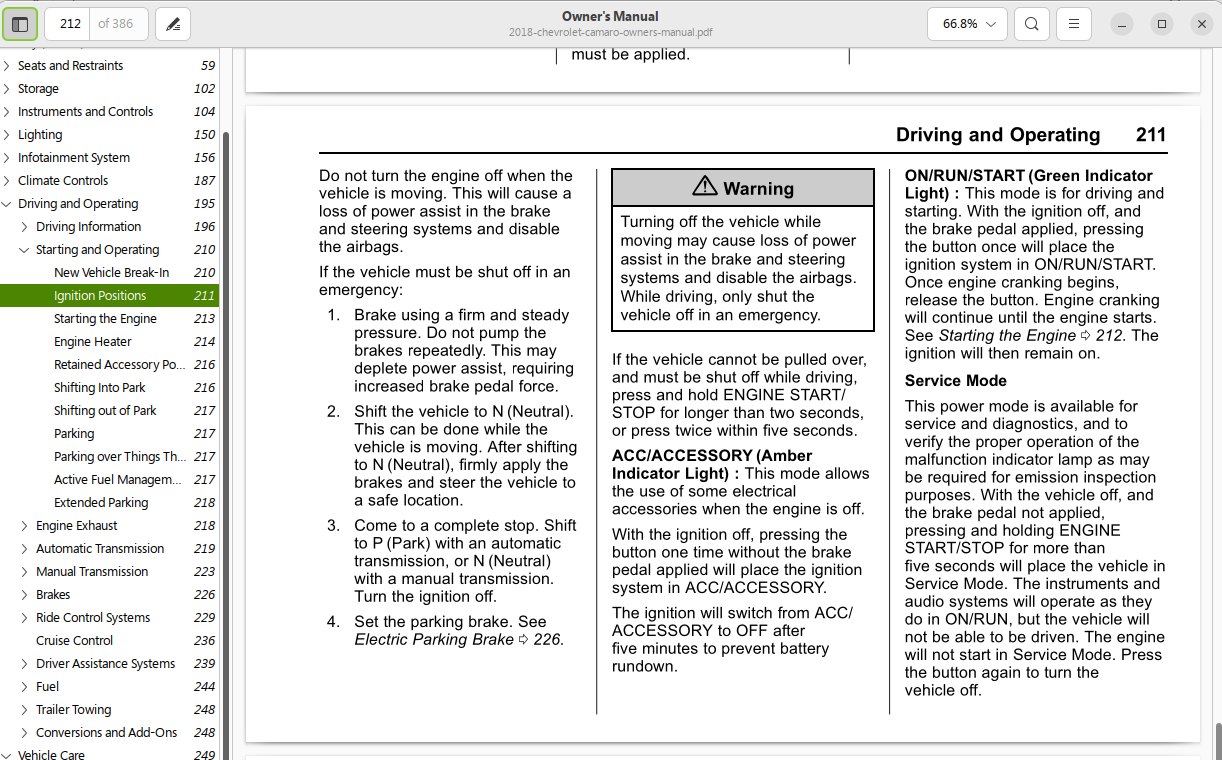

Yea I wasn’t holding the start button long enough. If you just press it, and release it quickly (like all the info online says) it turns the car into some kind of aux mode. Stereo comes on, dash lights up, etc. but the innercooler pump does not. But if I hold the button for 5+ seconds, it turns the innercooler pump on.

Technically, the first one is "accessory mode" that is only active for 5 minutes, and the one you enter by holding the start/stop button down for at least 5 seconds is called "service mode".
If one wants all electrical components to initialize and stay on longer, service mode is the ticket.
Thanks for the clarification, good to know!

Arpad is correct..."service mode" formerly known as "key on" is what I meant.
