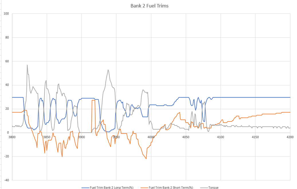

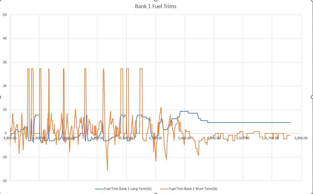

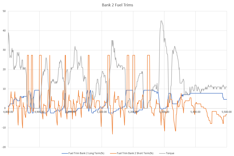

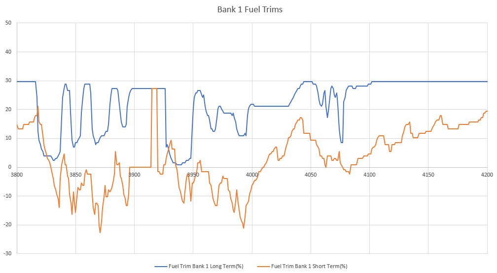

Figured I'd upload some plots with examples of the fuel trims for anyone weary of clicking on links.

Thanks for the reply, It makes sense that Intake or exhaust leaks might be the culprit. Fuel trim I see that both bank 1 and bank 2 have high long term trims (even though I'm only getting the bank 2 code). Would this tend to rule out an exhaust leak? I will definitely be going over the bolts and connections for the MSD.

Update: I'm made contact earlier in the day with the shop that did the work and the owner provided similar thoughts as you all. I ended up tightening the bolts on the MSD and confirming connections were tight. Long term fuel trims now look much better (just under 5% at idle on both banks). Still waiting for the light to go away, but the tuner has been very responsive and I've sent logs to him to have a look. I do wonder if the spikes in short term fuel trim are something to be concerned about. They seem to occur when i roll onto the throttle. I will let everybody know if anything more comes of this.
