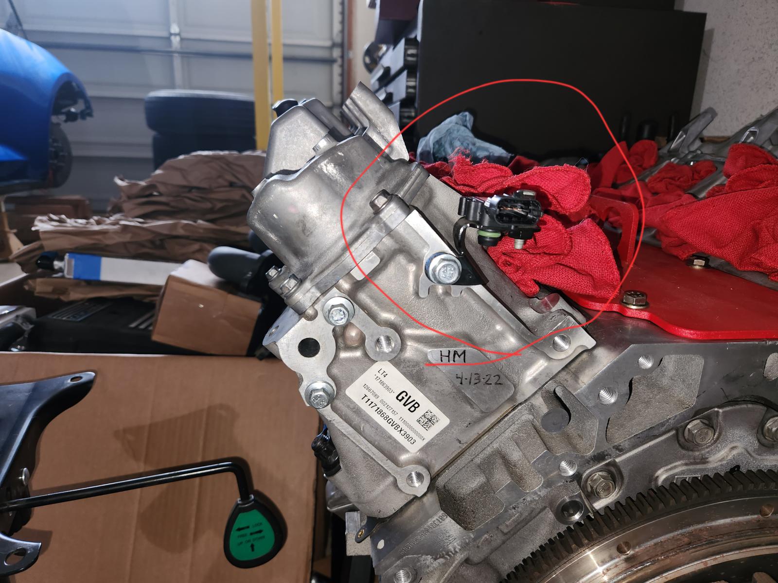

I have a 2016 Camaro SS that I recently purchased that came installed with a Magnuson Heartbeat Supercharger. It ran great until I got the opportunity to bask in the warm amber glow of the check engine light. It is a code P2230 Barometric Pressure Sensor 'A' Circuit Intermittent/Erratic. Tried clearing it and it comes right back immediately. Does anyone know where that sensor is located so I can change it out? Is it the one on the back of the blower (ACdelco PN 12592525)?

Back of the motor, driver side head.

Did you change the sensor i circled? That is the barometric sensor which is associated with p2230. If you changed the MAP sensor then that would be a different code. Their are actually two MAP sensors, one on the front of blower pre rotor pack, and one on the back post rotor pack entering the motor.
Just want to be clear as you stated you replaced the MAP sensor which is different than Baro Sensor.

Also check the wiring to each and make sure nothings burnt or broken. Forgot you had multiple codes
