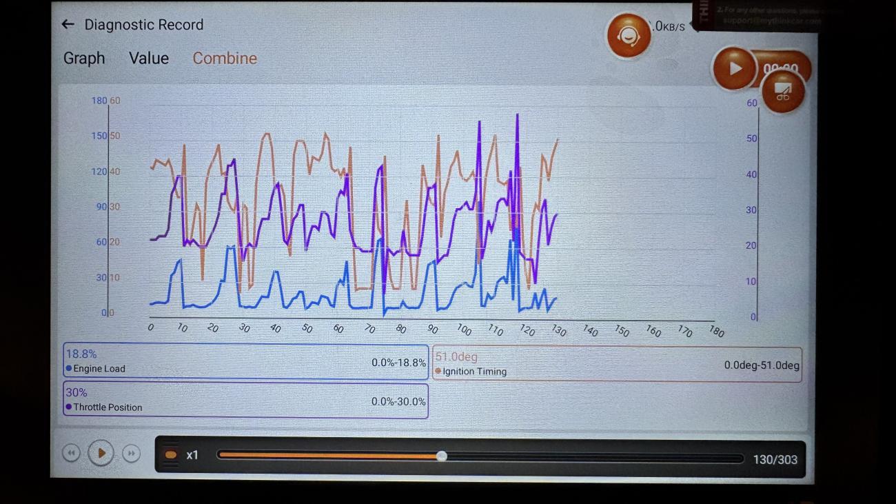

Under load the car is pinging/detonating.
Logging the ECU I can see that the timing looks way off.

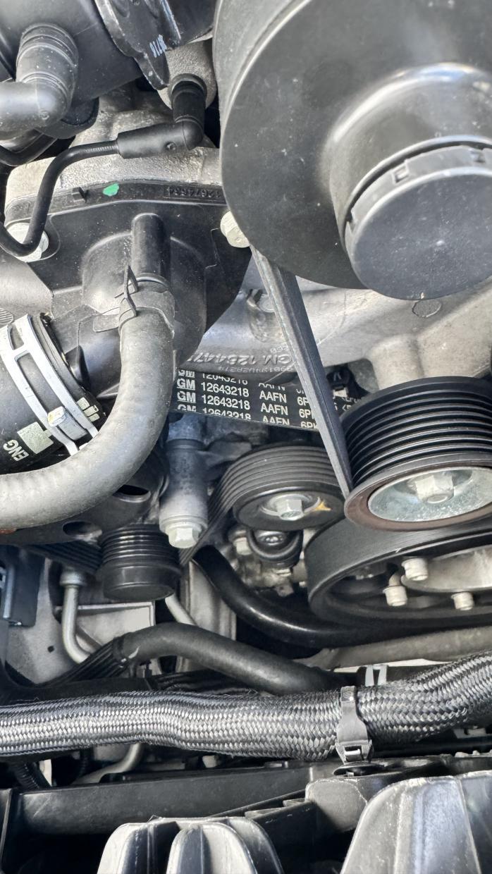

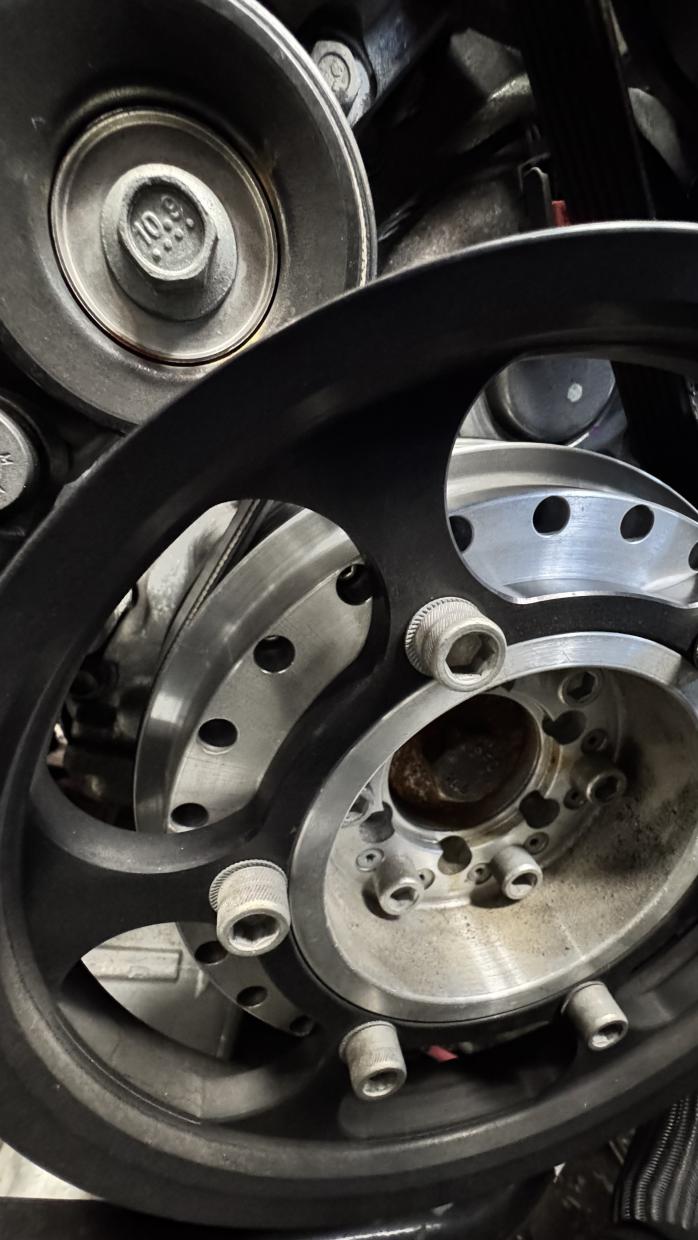

It looks like the Metco pulley kit is just the crank pulley, but can anyone on here confirm if the smaller pulley looks stock also?
I'm here in Ireland, and given the only ZL1 here, not easy for me to do a comparison

upper pully appears stock.

Ah ok, so does that timing above look right?
All my other cars are older carb'd V8's, so it was my thinking I shoudnt have more than 28 degs timing on the LT at WOT.
RobZL1, you're spot on - our EU95 is equivalent to your US 91 and our EU 98 (super) octane = US 93 octane. Am I right in my thinking a stock ZL1 would run fine on US91/EU95?

Got it. From the log, the throttle never opens more than 60%, and when it looks like you give it a little throttle, the timing drops down into what looks like the 8 degree range, which on a stock car with a big pulley seems about right. Maximum delivered timing at redline is likely only 16-20 degrees with a big lower pulley on stock blower/stock heads/stock cam car (depending on the size of the pulley). It ramps into that timing as RPM's climb.
