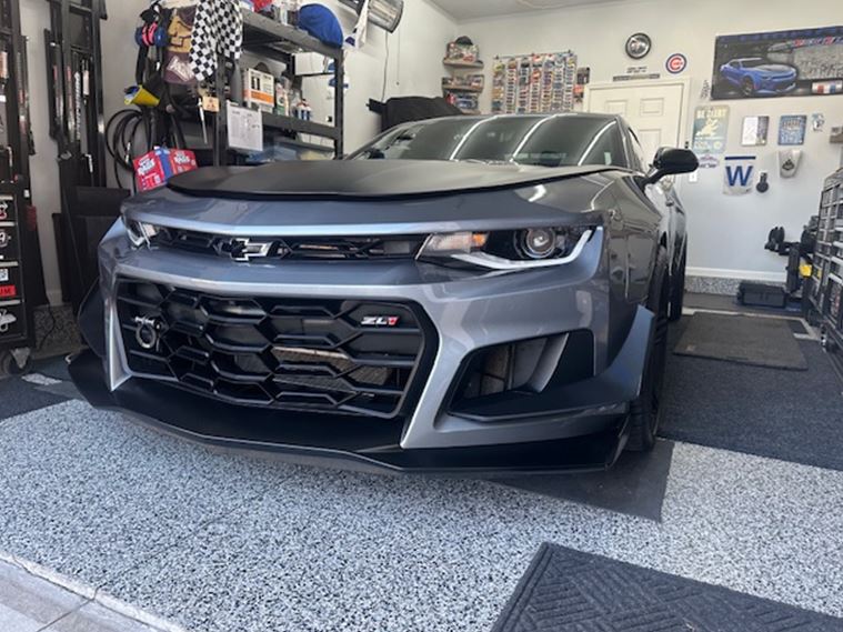

Ive done a few and every one after so many years started to peel/chip. The rustoleum professional topped with the professional clearcoat seemed to be the best. Ive had my last 2 garages professionally done using polyaspartic (spelling?) coating.
^^^This^^^
Don't do Epoxy and don't do yourself
Mine still looks exactly like the day it was done... My neighbors Epoxy is all sun faded, peeling and looks like crap.

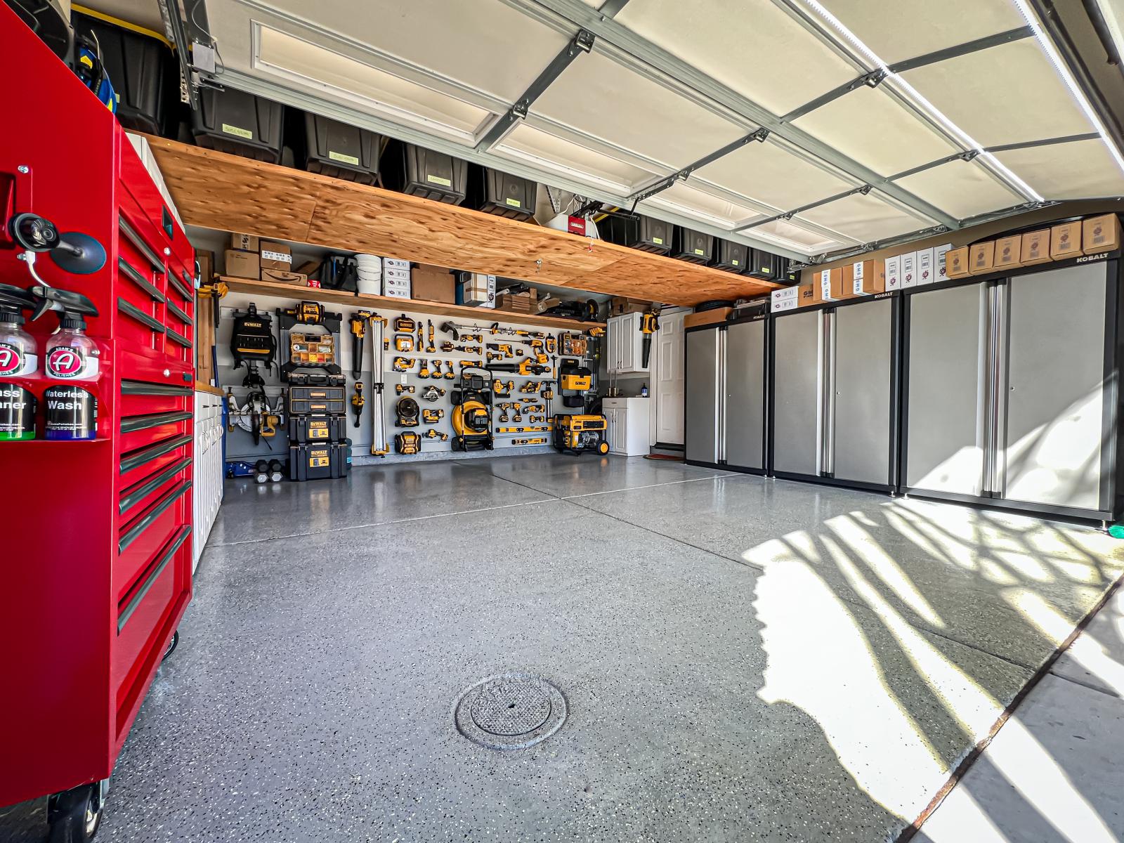

Had our Polyaspartic floor done professionally as well. Lifetime warranty for as long as we are in this house.
