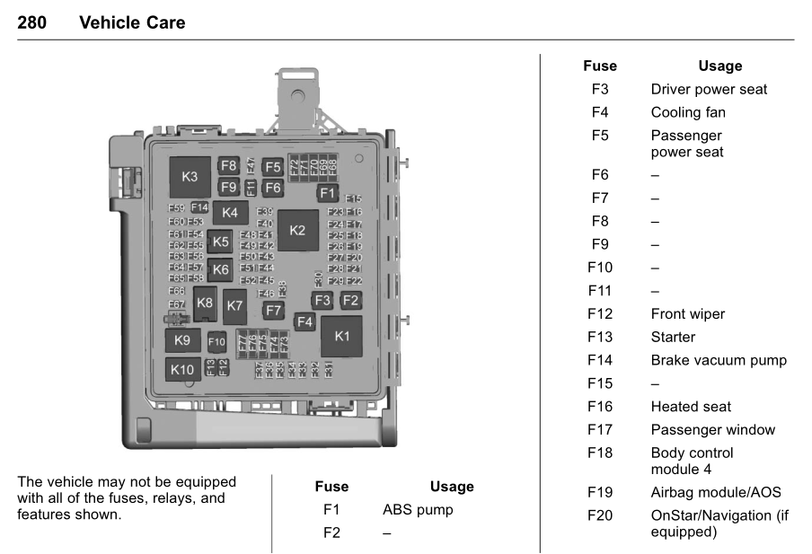

The starter relay and fuse are in the front fuse box, K10 and F13, respectively.
When these cars suffer water intrusion in the trunk, all bets are off, the entire rear fuse compartment needs to be inspected for rusting and shorts (the Bose amplifier, if equipped, may be a goner as well). That said, AFAIK no starter electricals are wired to that box, so you should at least hear the starter relay in the front activate when you push the start button.
If you get cranking action but no start after inspecting/replacing the fuse and relay up front, the fuel system control module fuse (F35) is in the rear fuse box, that may need attention, too.

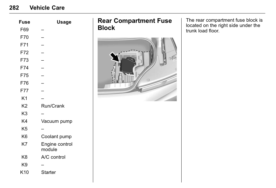

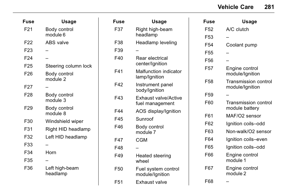

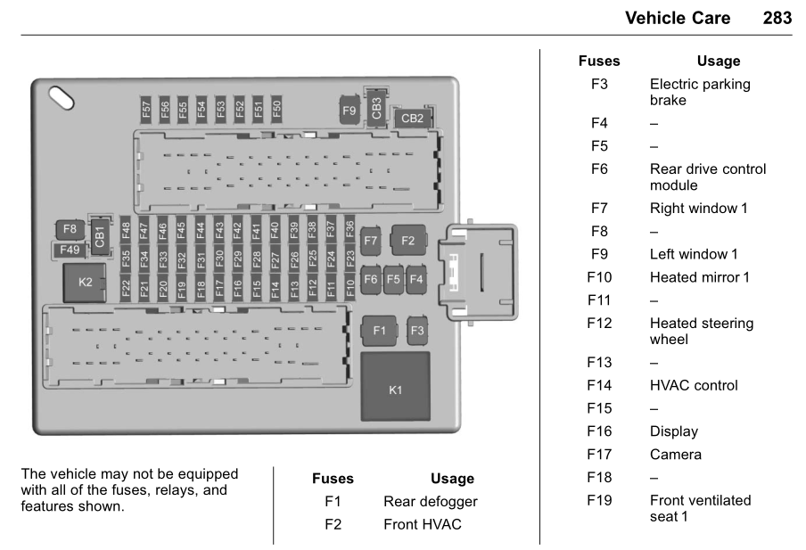

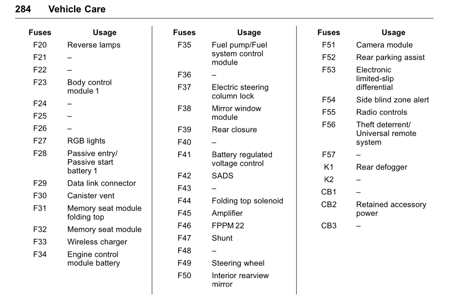

Posts: 13,476
Well, if you want to "play" whack-a-mole, here are the other relevant manual pages with fuse and relay info. Good luck, hope you'll figure it out eventually

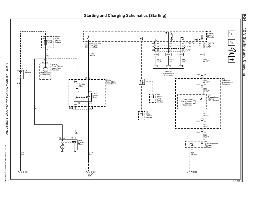

Posts: 13,476

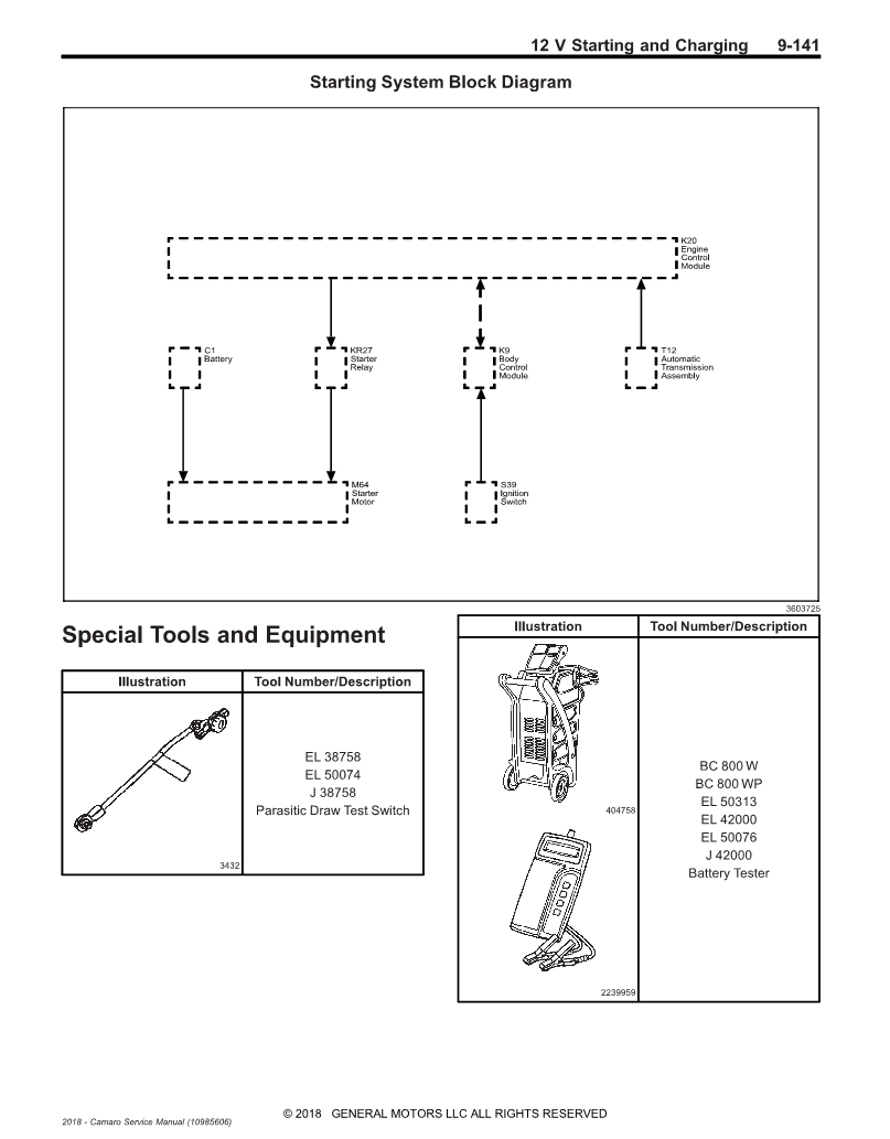

I have the 2018 service manual for my car, see a few related electrical diagrams below.

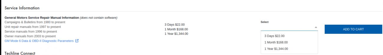

However, there are hundreds of pages about the starting and charging system alone, and the entire service manual is about 10k pages, with information and cross references spread throughout sections. There is no way anyone can post all the pertinent info here.
What I'd suggest is that you buy a 3-day subscription from AC Delco at https://www.acdelcotds.com/subscriptions, which gives you three days to download everything you need.
